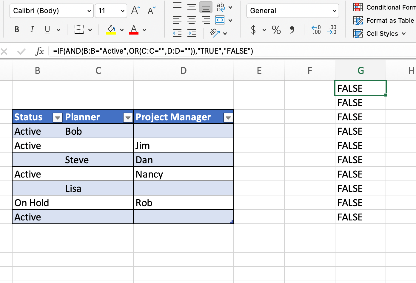

I'm trying to use a IF AND OR formula and for some reason I can't get it to work correctly. The formula isn't returning any error message but I know it's not working correctly based on the criteria I have filled in. Any idea why this isn't working for me?
Attached is a screenshot of the excel sheet and data and listed below is the current formula I am using.
=IF(AND(B:B="Active",OR(C:C="",D:D="")),"TRUE","FALSE")
Right now the formula is returning back each row as "FALSE" but based on the sample data I have I know that Rows 4, 5, 7, and 10 should have "TRUE" displayed because the status of column B is "Active" and at least one of Columns C and D (or both) are blank for all those rows.
Any help would be appreciated!

    AND and OR don't return an array, but a single TRUE/FALSE value.
    You could use
    =IF((B:B="Active")*((C:C="")+(D:D="")), TRUE)
    But I'd prefer to refer to the table instead of referring to entire columns.
    In E4:
    =AND([@Status]="Active", OR([@Planner]="", [@[Project Manager]]=""))
    This will add a column to the table.

    The issue that you are having is that AND and OR each only return one TRUE or FALSE result. They will not return a spilled result. So, they will not compare individual rows as the formula needs. To use AND and OR they will need to refer to individual rows and then be filled down.
    =IF(AND(B4="Active",OR(C4="",D4="")),"TRUE","FALSE")
    Actually, to use them you don't need the IF function either since the AND function already produces TRUE or FALSE. See Column H below.
    =AND(B4="Active",OR(C4="",D4=""))
