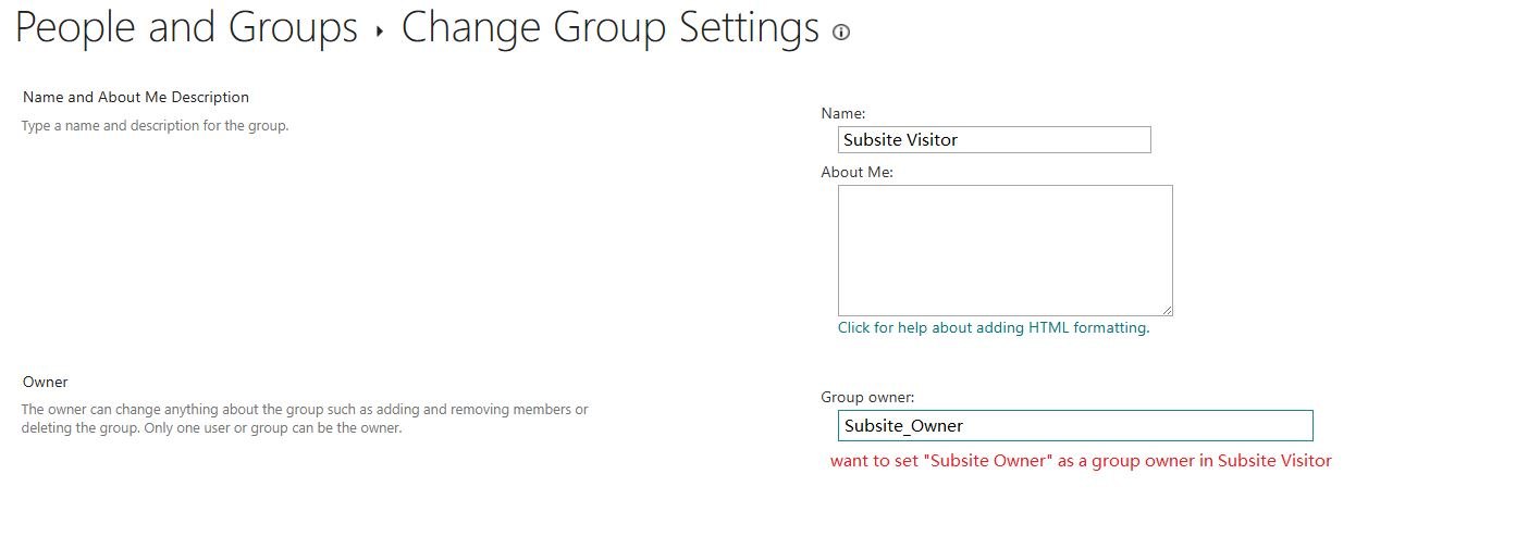

I want to assign a group to be the "Group Owner" of another group by Power Automate Cloud flow. Could you give me suggestion?

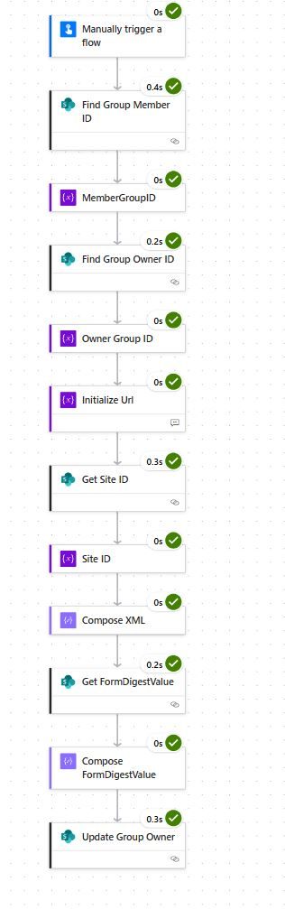

I have created a flow to create new subsite and new group with new users inside in SharePoint.
Everything goes well except group owner.
Here is screenshot where it can be found in SharePoint Permission setting.

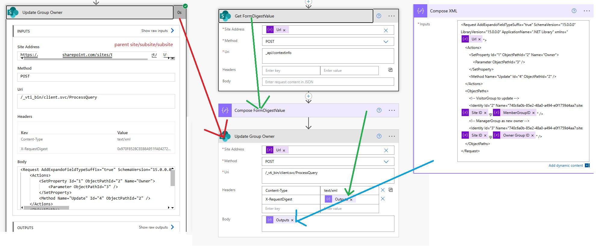

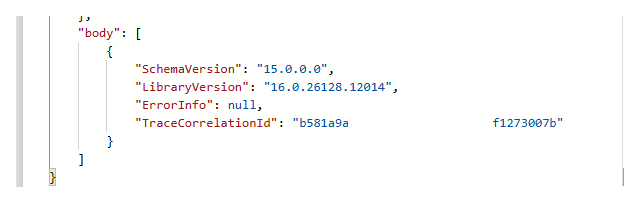

Here are what I can find online. I follow steps to update my cloud flow, however, it doesn't update the group owner as expected even the cloud flow runs successfully.
here are links:
Set a SharePoint Group owner with Power Automate - ESPC Conference, 2025
Can't add a Owner to a SharePoint group · Issue #957 · pnp/pnpjs
here are screenshot from cloud flow :

    • Are you getting any error responses from the PATCH call? → If yes, what is the status code and error message?
    • What response are you receiving from the Update Group Owner step? Is it a success code or an error?

    I create new group by automate flow with action " Send an HTTP Request to SharePoint" and it assigns the connection reference account as group owner.

    • Are you trying to set the owner as a user or another group? Graph API typically supports assigning ownership to users only. No, I don't because the requirement is to set a group as a group owner.

    • Does the user exist and have permissions to be assigned as owner? I can manually assign a group as group owner. So i think that is yes.

    • Are you getting any error responses from the PATCH call? → If yes, what is the status code and error message? Questions about bearer token : I don't have bearer token, seem it doesn't mention from the links I found, but they mention about the FormDigestValue. And no I don't try Patch.. only Post and Get
