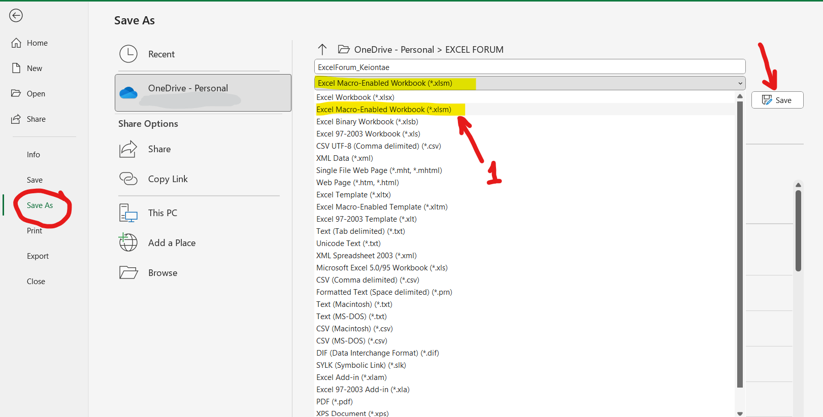

    1. Make a copy of your workbook and save it as an Excel Macro-Enabled Workbook (*.xlsm)

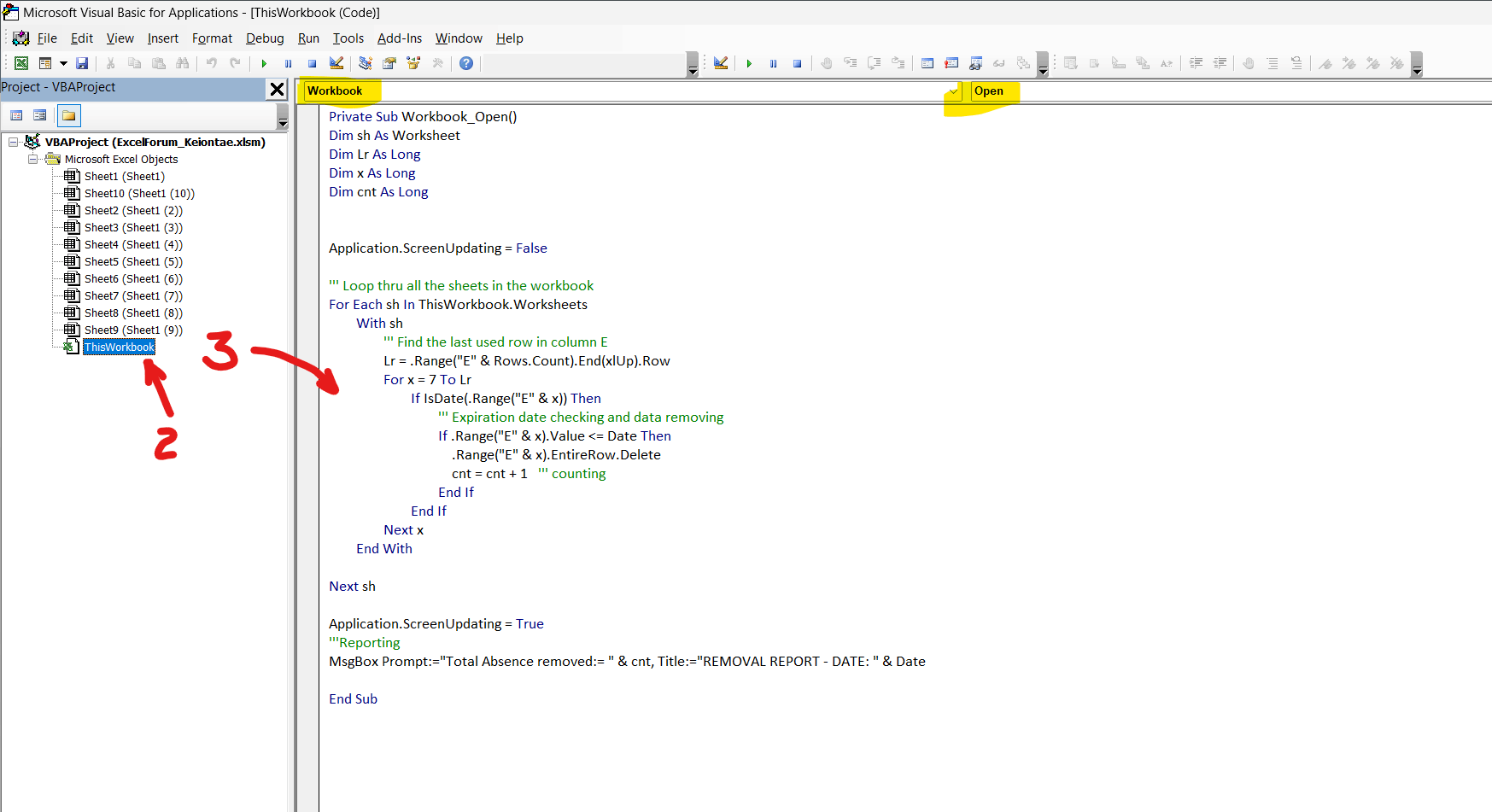

    1. On your keyboard, press: ALT+F11. This will prompt the VBA edit panel. Then Double-click on "Thisworkbook"
    2. Copy and paste the code into the Workbook's Open Procedure VBA editor as shown in the picture below.

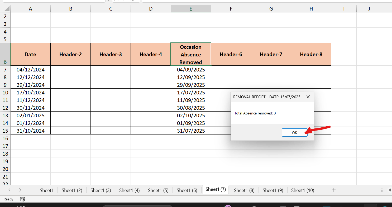

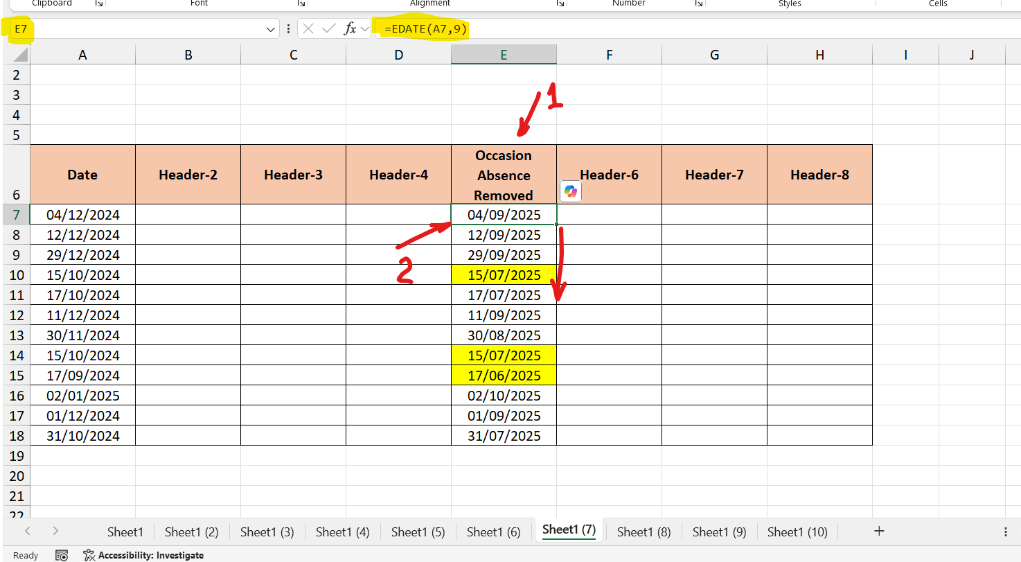

    I partially reproduced your scenario for illustration purposes
    The following VBA code was written assuming the following:
    1. All the sheet tabs have a similar structure, with the "Occasion Absence Removed" field in column E as the field that calculates the 9-month date from column A.
    2. The data values start in row 7 downwards.
    The sample picture highlights the three dates on which rows must be removed.
    The code will execute when the Workbook opens.
    It will loop through each sheet in the workbook, then loop through all the used cells in column E, checking if the date in the cell is less than or equal to the current date, and delete the entire row with data if it is true.
    The code shows a pop-up reporting message

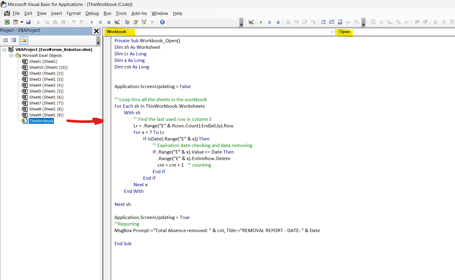

    The picture shows where the code must be placed.
    Here is the code:

    MsgBox Prompt:="Total Absence removed: " & cnt, Title:="REMOVAL REPORT - DATE: " & Date
    End Sub

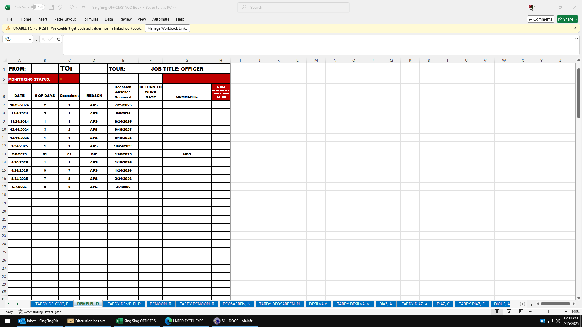

    YOU SEE THE DATE ON THE LEFT IS WHAT WE ENTER, THEN HOWEVER MANY POINTS IS ENTERED UNDER THE OCCASIONS ROW, 9 MONTHS FROM THAT DATE IS WHEN THE OCCASION POINT IS REMOVED.  I JUST WANT THE INFORMATION TO AUTOMATICALLY CLEAR EVERY TIME YOU OPEN THE WORKBOOK INSTEAD OF GOING INTO EACH AND EVERY TAB INDIVIDUALLY.  THANK YOU :)

    Please, post pictures of your table(s), and explain to us what you mean by "...clear out..."?
