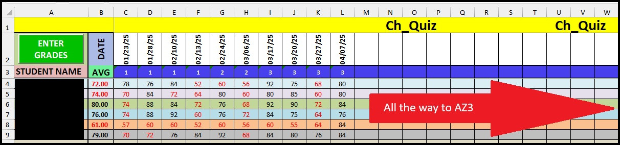

The line of code in bold green is not working. As you can see, I have checks trying to troubleshoot the issue using ACTIVIATE, SELECT and MSGBOX to make sure I am looking at the correct range. Other than the specific range indicated, this line of code is copied and pasted into this routine and it works in the other routine that I copied it from. I have not completed the coding in the routine because I cannot get the lastcol to work. The range is formatted as TEXT. I tested it with the NUMBER format but it did not change anything.
I am trying to find the last column with data in order to add one to get to the first blank column. In the screenshot below the code, C3:L3 has data and M3:AZ3 are blank.

  1. HansV 462.6K Reputation points
    2025-04-29T22:13:28+00:00
    In your screenshot, the last non-blank column in row 3 is column L, that is the 12th column. So the result 12 is correct.

    2025-04-29T15:46:03+00:00
    Sorry for taking so long to get back. Got busy. This formula renders the same answer as lastcol = Range("BA3").End(xltoLeft).Column does.
    lastcol should be 10, but it equals 12 instead. I have selected all the "empty cells in row 3 to be sure there is nothing in it. I also tried the "<>0" that you suggested and the answer was 49.

    2025-04-22T15:47:07+00:00
    For some reason, lastcol = 12 when it should equal 10. I have deleted any unseen characters from the cells after column L and it still chooses 12.
    Is there a way to look at it from left to right?
