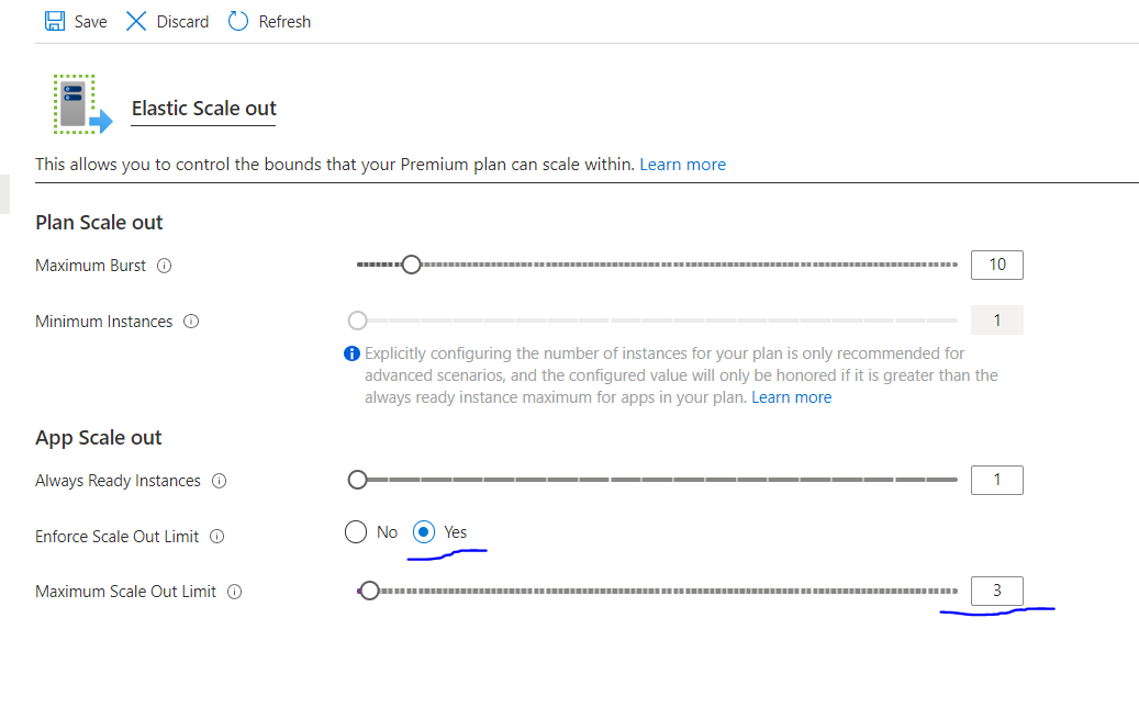

We wanted to implement Enforce Scale out Limit - to yes and Max Scale Out Limit - 3 through ARM template under Azure Function premium plan .We are able to do this on Azure Portal but failed to implement with ARM template.
So far we have tried these properties which are suggested in Microsoft Documentation Property Name: Functionappscalelimit and reservedinstancecount we are not getting any error but at the same time , it is not reflecting at all.
Here is the snapshot of the property on Azure portal which we wanted to change through ARM template.

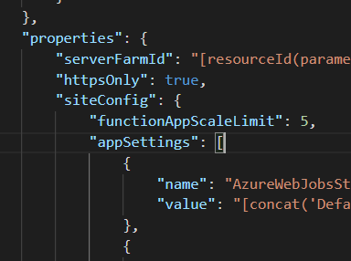

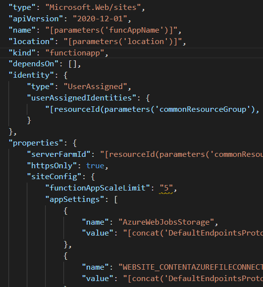

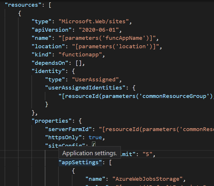

    The particular setting ( functionAppScaleLimit ) is documented here: Event-driven Scaling. On the ARM side of things, it belongs to the same Microsoft.Web/sites resource type that Functions uses: https://learn.microsoft.com/en-us/azure/templates/microsoft.web/sites?tabs=json
    Sample:
      "name": "string",
      "type": "Microsoft.Web/sites",
      "apiVersion": "2020-12-01",
      "kind": "functionapp",
      "location": "string",
      "tags": {},
      "properties": {
          "SiteConfig":{
              "functionAppScaleLimit": "integer",
    Hope this helps, let me know if you run into issues.
