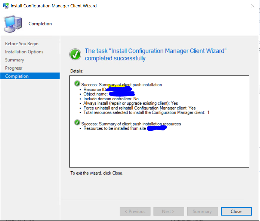

    Within MECM itself, I run through Install Config Manager Client Wizard and I receive a 'completed successfully' notification (please see attachment). However, when jumping on the client itself I can see that the install did not complete. Judging from the logs I can see that the install gets underway but does not complete.
    Would it be helpful for me to upload the logs, so you can take a look and try to identify the issue? I'm afraid the log results don't make much sense to me...

    You may start from checking the ccm.log on site server and ccmsetup.log on client.
    For more details, we may refer to this article:
    https://learn.microsoft.com/en-us/archive/blogs/sudheesn/troubleshooting-sccm-part-i-client-push-installation
