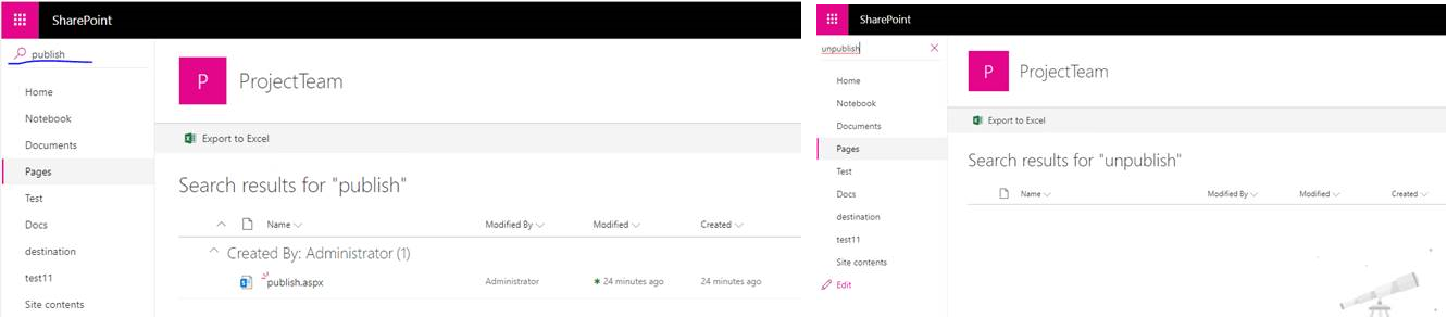

    Per my test, I create two pages, one is published and the other one is unpublished.
    Please note that the "Unpublish" page has not been published since it was created, and then run a full crawl:
    Normally, after the crawl complete, I could search for the published page successfully, however the unpublished page will not be crawled and searched.

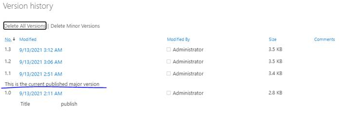

    So for your issue, you could check the version history of the page to see if the page has been published before, if it has been crawled before, the page will be searched even if you edit the page later without publishing it.
