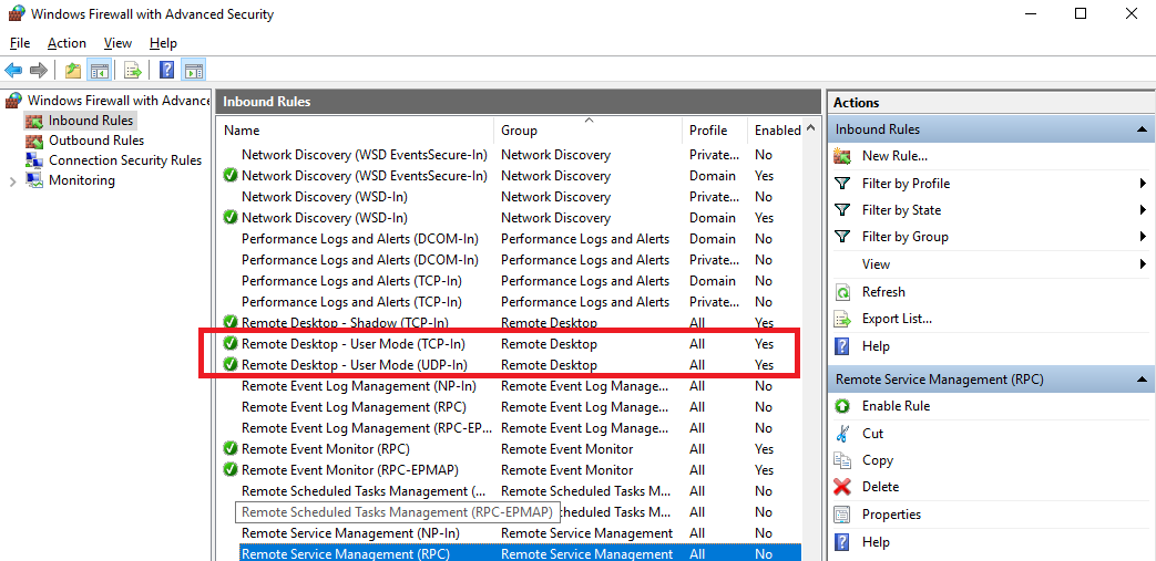

  • checked windows firewall to see whether the inbound port rule is correct & allowed (yes)
