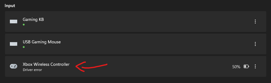

So I connected my xbox controller through bluetooth, then I got this error:

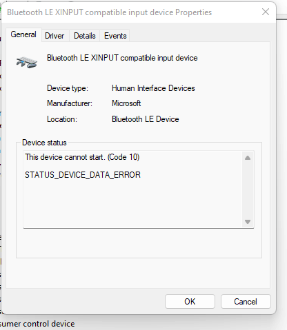

I went to device manager and saw this error:
General tab:

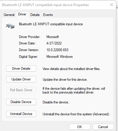

Driver tab

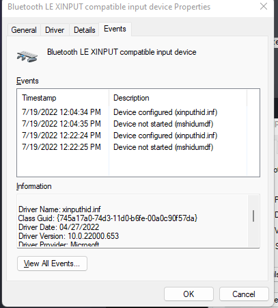

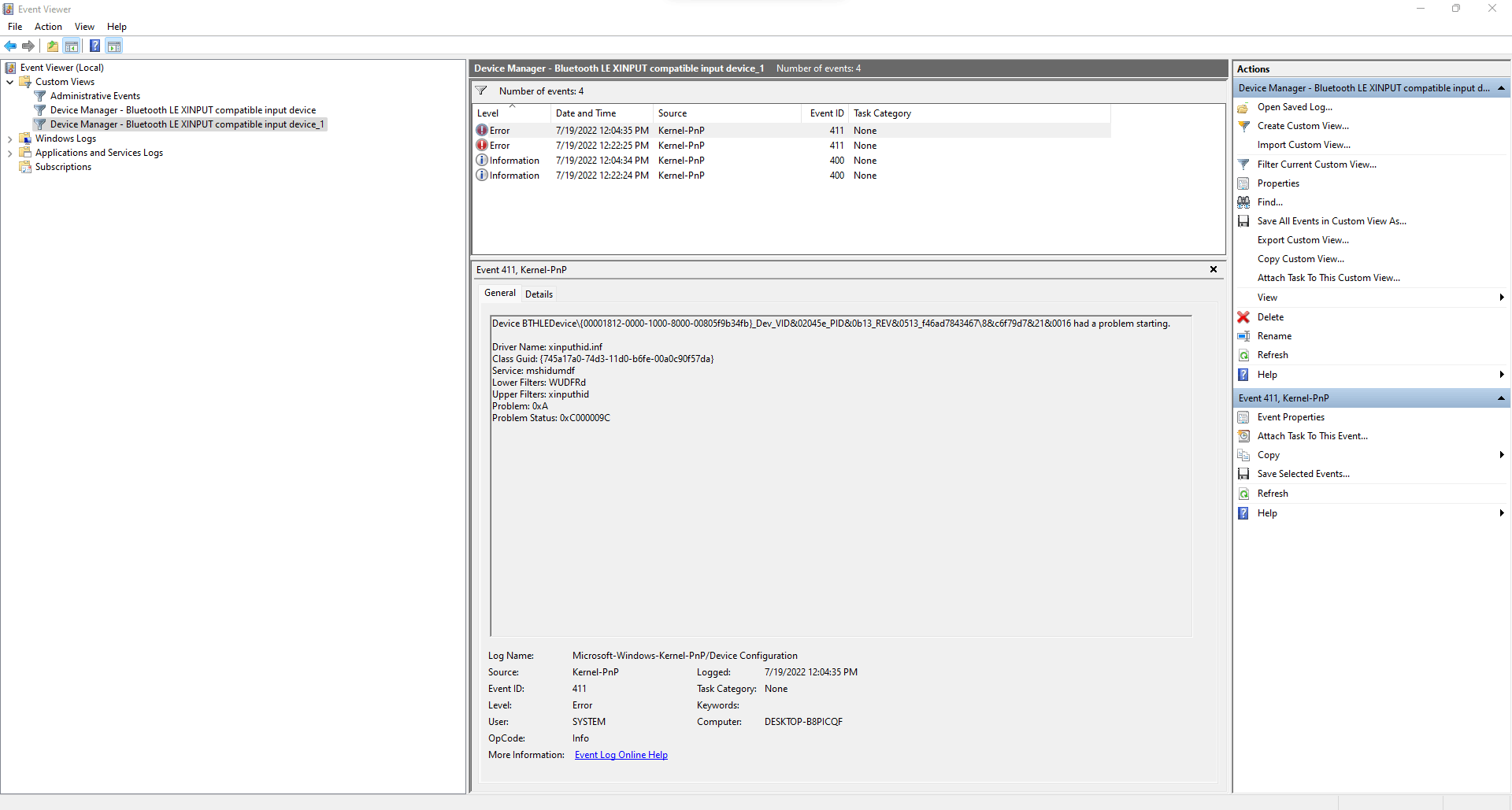

and this is what I got:
Event viewer:
Things I tried:
1- DISM check - restore operation completed successfully
2- sfc /scannow - Windows resource protection did not find any integrity violations
3- Uninstall error driver, then restart - still driver error upon reconnecting
3- clean install windows 10 (keep files and apps) - driver error upon reconnecting
4- upgrade to windows 11 - driver error upon reconnecting
5- update the xbox controller firmware in Xbox Accessories app - still driver error upon reconnecting.

    Update | Reset Pc/Laptop as New So my last resort was to reset everything as new i mean i dont have really important files other than my resumes but i have it on my phone so i did reset it again and set it up as a new pc/laptop and now it works I guess the problem on keeping the files is it kept what your setting was and never really changed anything so whatever problem you have after you reset the pc/laptop you still have it so now its working. Also i have a problem before when i plug my phone for data transfer and its not reading the phone coz the driver of that particular thing is not working i think it was the MTP Portable Device and after i completely reset everything as new it worked fine
