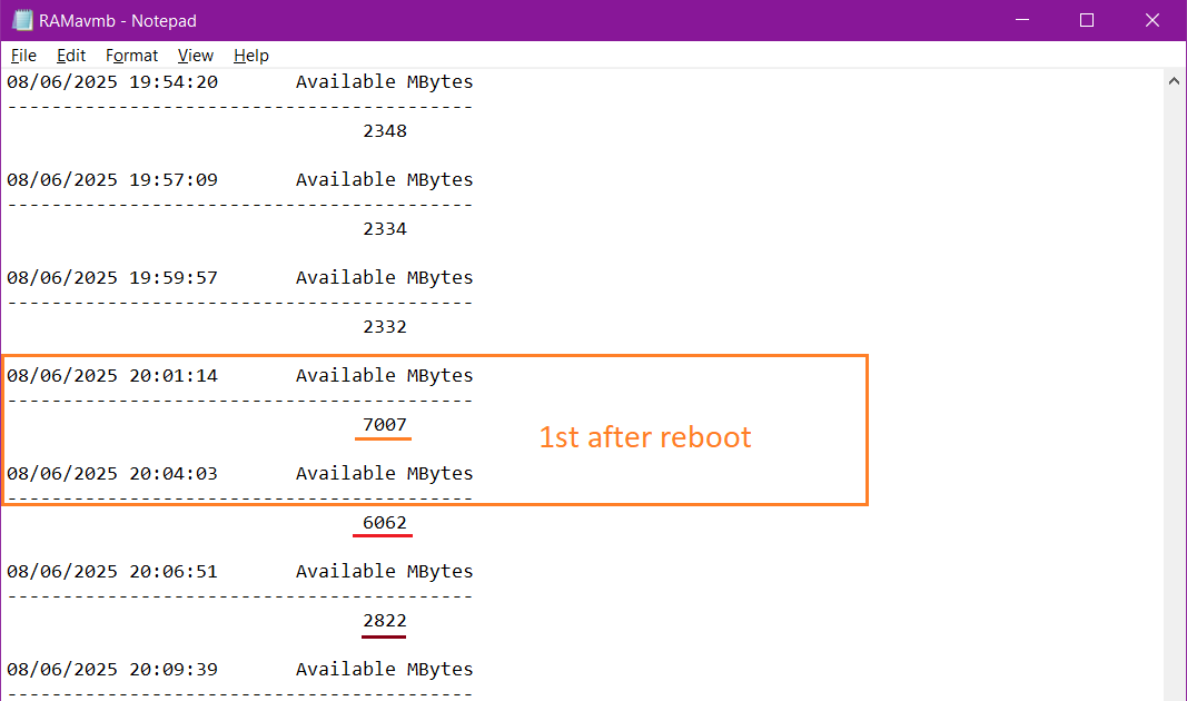

On one of my DCs available memory drops from 7GB to <3GB during 4-5 minutes after reboot:
4-2
At 20:01 = 7007MB
At 20:06 = 2822 MB

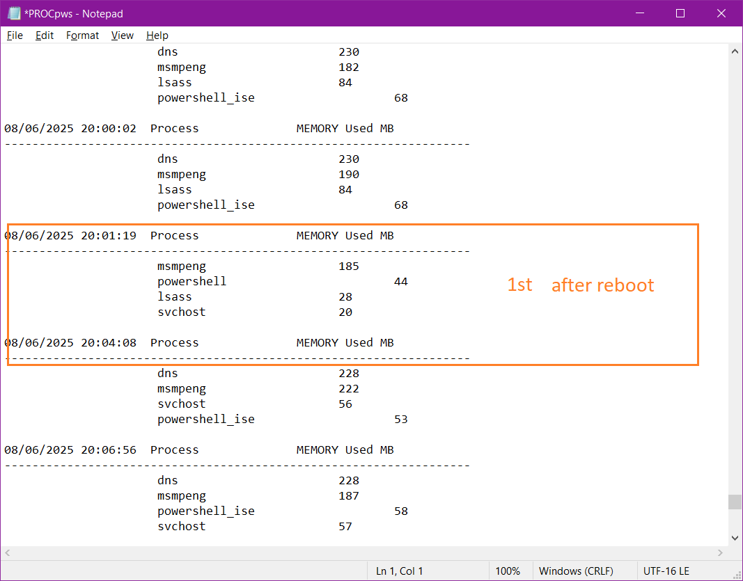

I have a script that continiously monitors processes and logs the ones with the most memory consumptions - and these don't change except for the first script run after the server's restart:
4-1
I don't see any process(s) that consumes so much memory and don't see any related errors in the log either so
What can I do to find the culprit process(s)?

    In this case the Security.evtx file seems to be cause of the issue: for I'am using the scripts that read Security log, the used memory increases with the increase of Security.evtx.
    MotoX80, thank you very much for the RAMMAP - it helped a lot!!!
