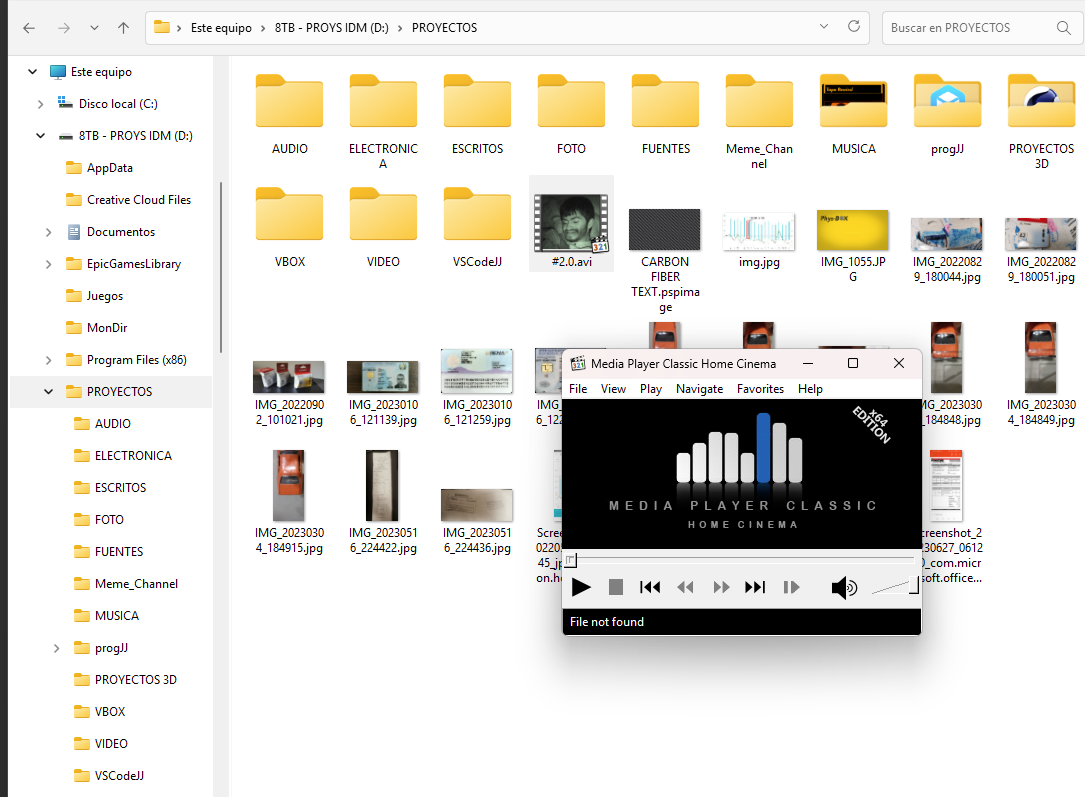

After the update KB5063878 for Windows 11 my secondary 8TB Seagate Barracuda (ST8000DMZ04/004, GPT/NTFS) was instantly corrupted and turned RAW. This is not my OS drive – it is a dedicated storage drive with professional projects and databases, now completely inaccessible. Windows Explorer still lists folders, but all files fail to open. This is a critical data loss scenario triggered directly by KB5063878, and I need acknowledgement and a real solution for recovery.

Hibernation and Fast Startup were enabled. With 128GB RAM, hiberfil.sys (~100+ GB) was located on the 8TB secondary disk. After applying KB5063878 and rebooting, the 8TB drive immediately showed as RAW instead of GPT/NTFS.

Windows Explorer still shows folder names, but all files fail to open.

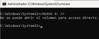

CHKDSK fails with: “The type of the file system is RAW. CHKDSK is not available for RAW drives.”

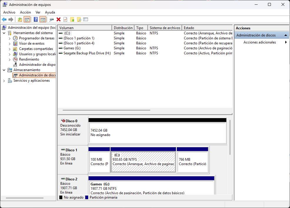

Windows Disk Management detects the disk but marks it as invalid.

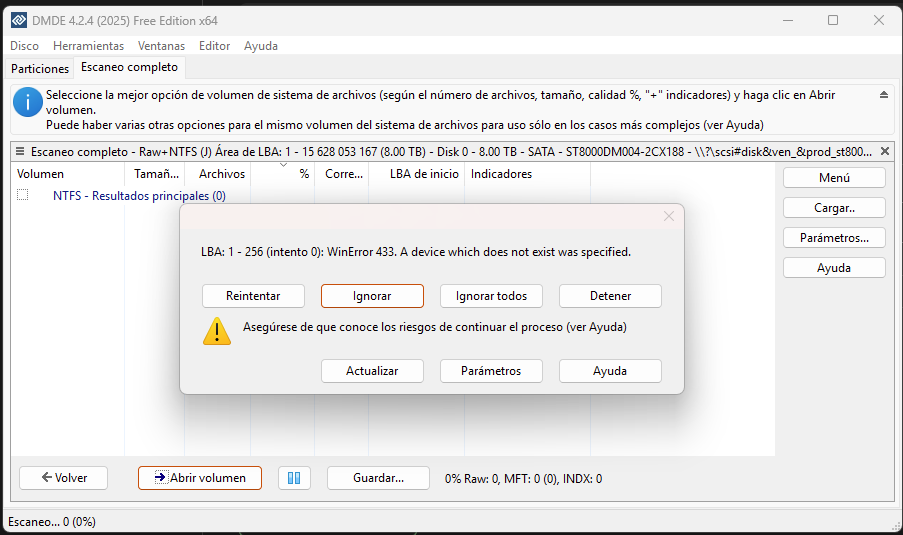

Recovery tools (R-Studio, DMDE, UFS Explorer) detect sectors but report corrupt MBR and invalid partitions.

Third-party recovery scans confirm sectors are present, but the NTFS structure is corrupted.

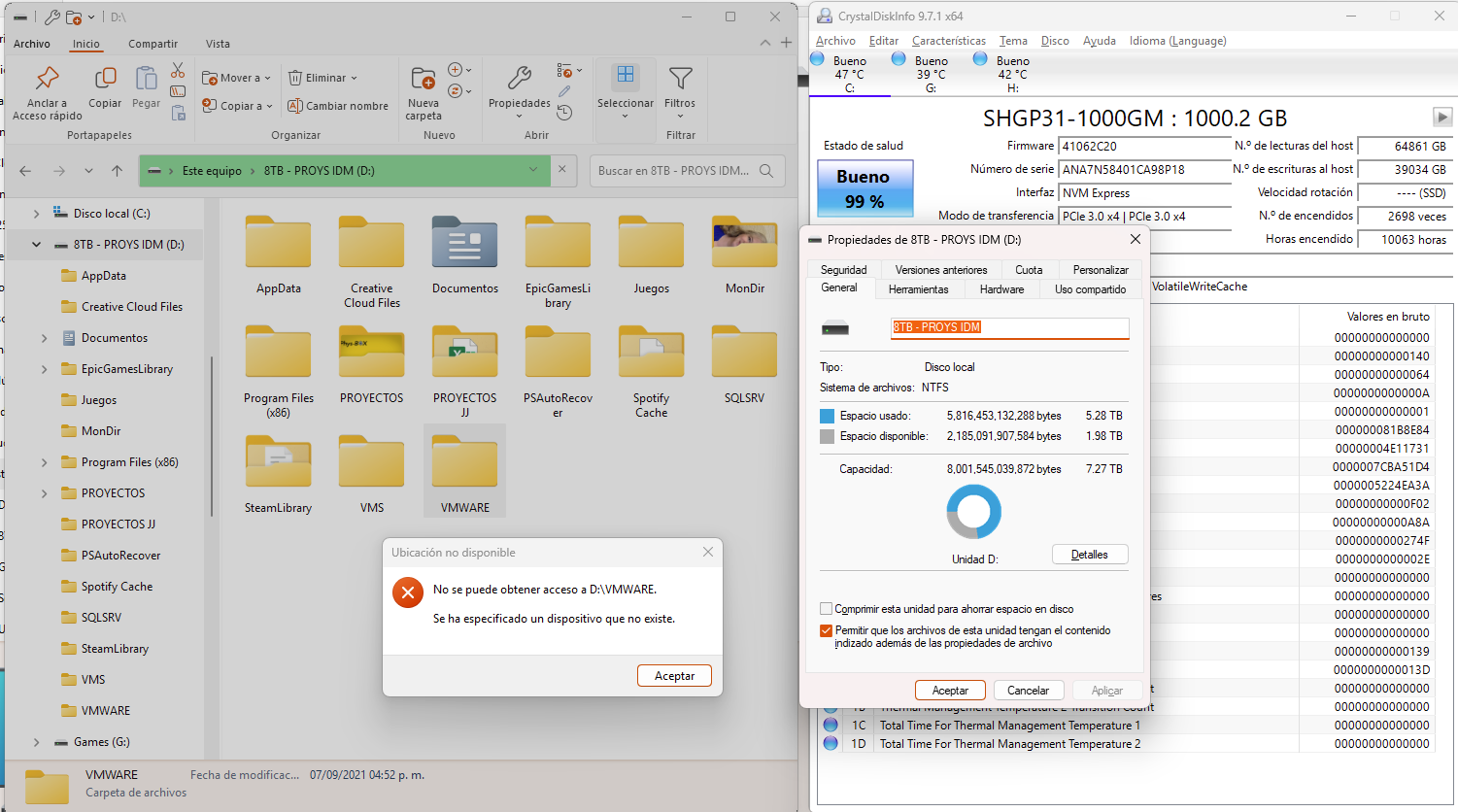

I can see my files and navigate thorough them, but when I try to use the opener application indicates that this file or folder don't exist, only 3 files are readable, one of them is an application that run fine from the disk, the same behavior when load the disk on windows 10.

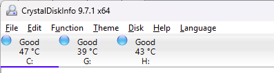

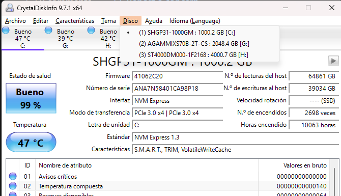

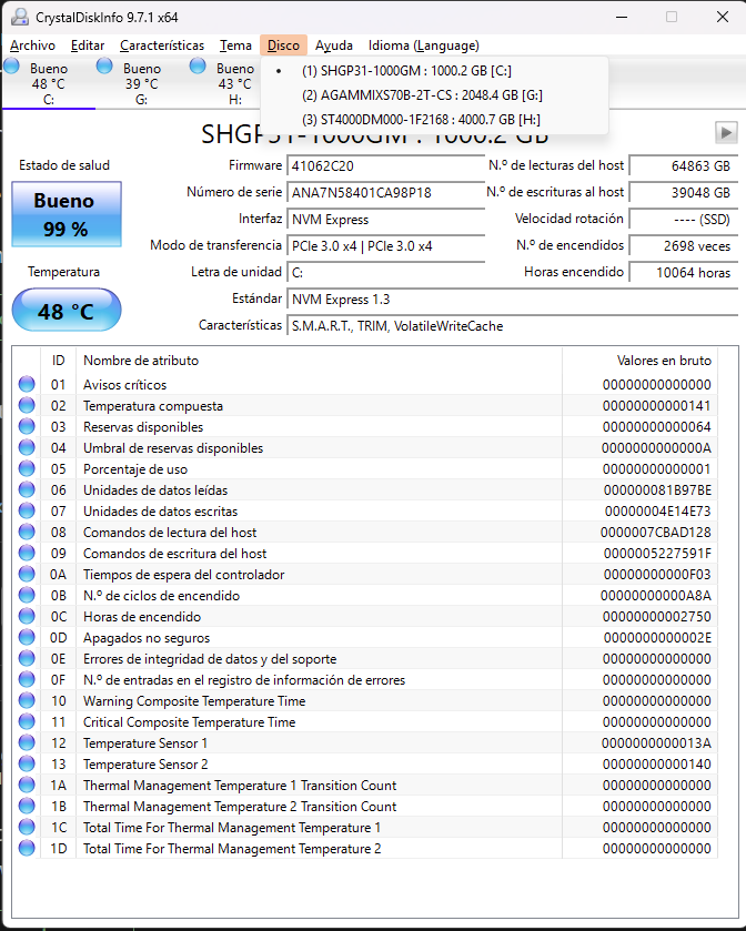

    Please check drive's health with third-party CrystalDiskInfo tool and show the result.

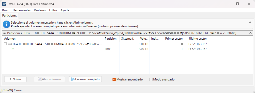

    Run third-party DMDE tool, open the drive as a physical device and show partition table.
  3. Igor Leyko 107.4K Reputation points Independent Advisor
    2025-08-26T01:31:53.4266667+00:00
    Unfortunately, CrystalDiskInfo window is overlapped and I cannot see it. Please show entire window. And I did not find DMDE result.
  4. Igor Leyko 107.4K Reputation points Independent Advisor
    2025-08-26T01:42:29.55+00:00

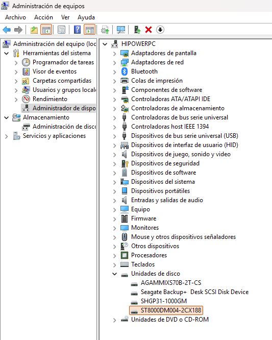

    This is not 8 TB drive data. And please open Device manager and show a list of hard drives.

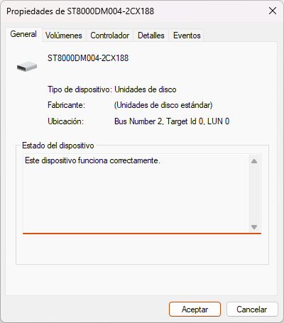

  5. Igor Leyko 107.4K Reputation points Independent Advisor
    2025-08-26T01:57:33.0766667+00:00

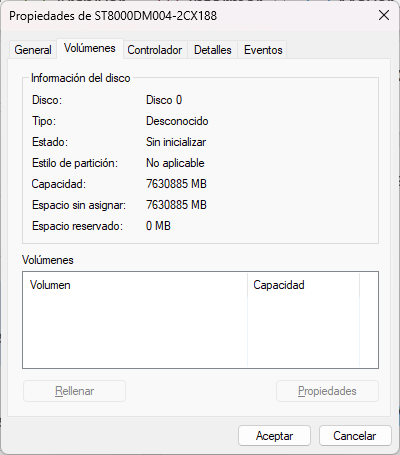

    In drive;s properties in Devise manager please open Volumes tab, click on Populate, wait the result, and show a screenshot.
