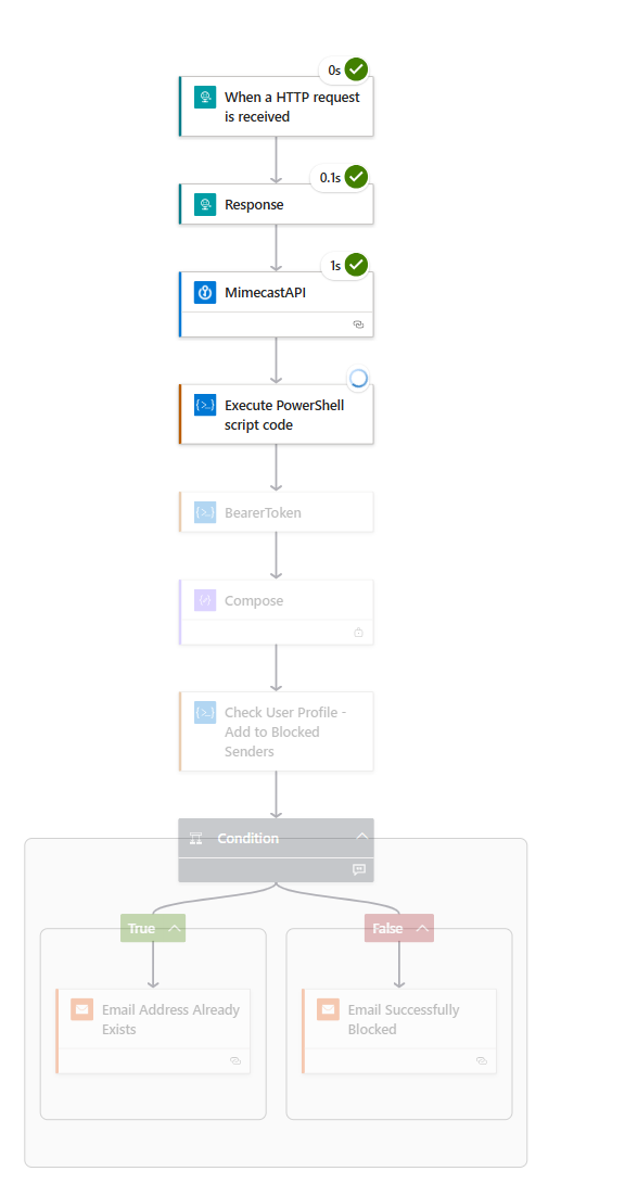

I've had workflows within my Logic App working perfectly fine until yesterday. Whenever they are triggered, they remain in a perpetual running state until I cancel them. They all get stuck at the Inline Code section.
Note
  • This has been working perfectly fine for the last 3 months.
  • I tested it with the default "Hello World" and it didn't work so it's not my script/code
  • I also made the configuration change and updated the FUNCTIONS_EXTENSION_VERSION to 4.837.1.23604

    A sudden failure of previously operational Logic App workflows, particularly within Inline Code operations, indicates a platform-level runtime disruption rather than a code defect. The issue almost certainly stems from Azure's deprecation of the underlying Node.js version that powered the Functions runtime. Your Logic App's configuration was likely dependent on a now-retired version, such as Node.js 14 or 16, causing the initialization process to hang indefinitely.
    The solution requires explicitly overriding the default platform setting by defining a new application configuration, WEBSITE_NODE_DEFAULT_VERSION, with a value of ~18 to mandate the use of a current, supported Long-Term Support version. This forces the runtime onto a stable and compatible foundation, resolving the initialization failure. Consequently, the Inline Code action can then execute successfully, allowing your workflows to proceed to completion without further interruption.
