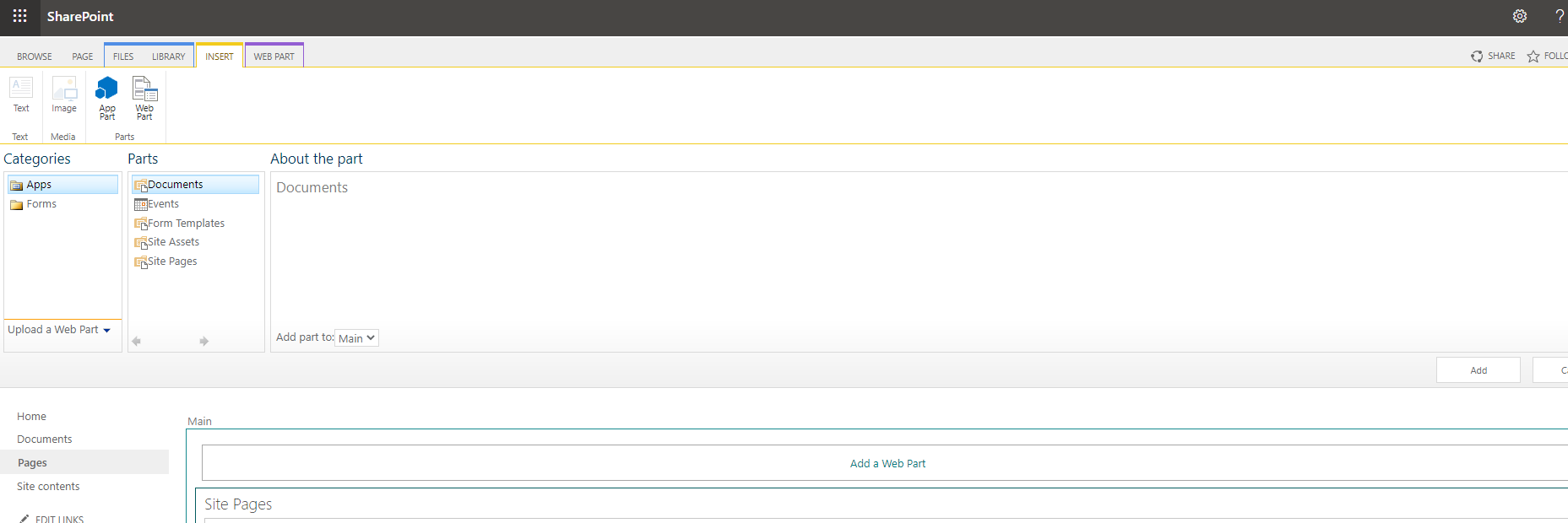

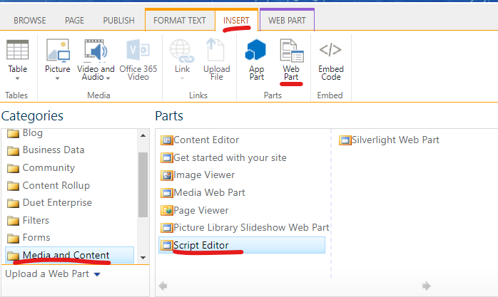

  3. nickas123 21 Reputation points
    2021-09-17T11:19:14.137+00:00
    In that can't find media and content script editor.
