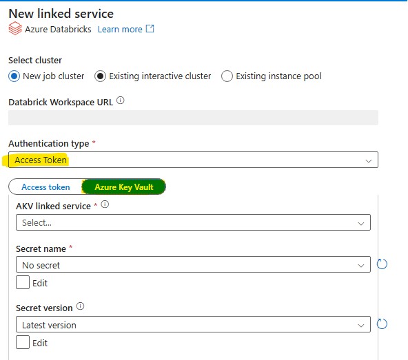

    Here are the few important notes which needs to understand while setting up service principle with Azure Databricks:
    • Service Principals cannot log into the Databricks UI; they are meant for automation and API access only.
    • If you don’t see “Service Principal” as an option in ADF, use the Access Token method with a token generated via SP credentials.
    • Managed Identity is preferred for production due to its simplicity and security.

    Thank you for reviewing the previously provided steps. Below are a few additional actions that may assist in addressing your concern -

    Use Azure Data Factory (ADF) ADF does not explicitly list "Service Principal" as an authentication method. Instead: Use the Access Token option. Ensure the token is generated using service principal credentials.
    When a notebook runs in Databricks, the identity it uses depends on who actually triggers the job—not who created the token. So, if you want the job to reflect the service principal's identity, it needs to be launched by the service principal itself using the API, CLI, or an automated tool—not manually through the user interface.
