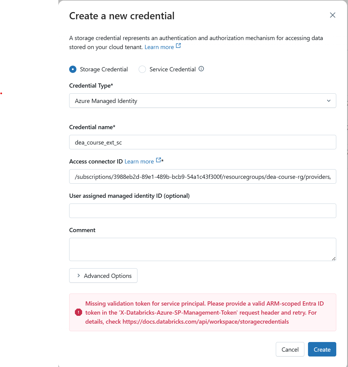

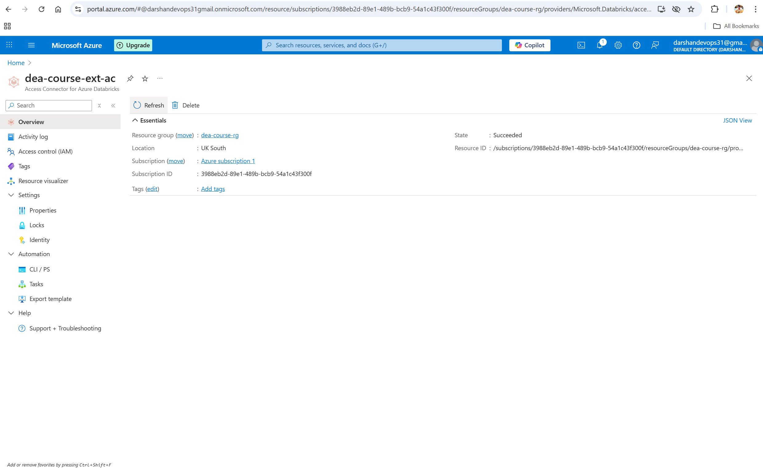

I set up an Access Connector for Azure Databricks and granted it Blob Contributor access on the target storage account. Since service credentials are required, I tried creating them using this Access Connector (managed identity). However, I keep getting the following error:
Missing validation token for service principal. Please provide a valid ARM-scoped Entra ID token in the 'X-Databricks-Azure-SP-Management-Token' request header and retry. For details, check https://docs.databricks.com/api/workspace/storagecredentials
I’ve been stuck on this issue for the past three days and haven’t been able to resolve it. Has anyone encountered this before or knows what I might be missing?
Happy to share more details if needed. Thanks in advance for your help!Screenshot 2025-09-14 010026

  1. Sina Salam 26,661 Reputation points Volunteer Moderator
    2025-09-16T12:20:00.9766667+00:00
    Hello Darshan Jain,
    Welcome to the Microsoft Q&A and thank you for posting your questions here.
    I understand that you are having error creating service credentials from Access Connector in Azure Databricks.
    The error occurs because Databricks requires two tokens when creating service/storage credentials with an Access Connector: a Databricks API token (Authorization: Bearer) and an ARM-scoped Entra ID token (X-Databricks-Azure-SP-Management-Token) obtained for the scope https://management.azure.com/.default. If you’re using the UI, Databricks handles this automatically once the Access Connector’s managed identity has Storage Blob Data Contributor on the storage account; if automating API/Terraform, you must explicitly fetch the ARM token via a service principal OAuth flow or IMDS for managed identities, then include it with the Databricks call as shown in the Databricks storage credentials API docs.
    I hope this is helpful! Do not hesitate to let me know if you have any other questions or clarifications.

    • My Storage Account has a managed identity role assignment for the Access Connector which has a role of Storage Blob Data Contributor access.
    • Note: I am the owner of my subscription.

    • In the top-left dropdown, make sure you're in the Unity Catalog metastore (not Hive or legacy catalogs) and continue creating the credentials. Here's a snip of the credential that I created. Let us know if you need anything further. User's image
