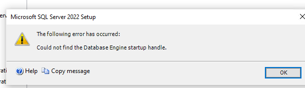

Installing SQL Server 2017, on a Windows Server 2019 standard, inside a Hyper V Windows VM.
Gordon Aleksin 0 Reputation points
2025-09-23T12:57:02.1666667+00:00
Screenshot 2025-09-22 073856
It only happens on a Hyper V VM. I have installed SQL on hundreds of servers, with no issues.
Also tried Windows Server 2016 / 2022 and SQL Server 2019 / 2022. And I have full rights to the server.

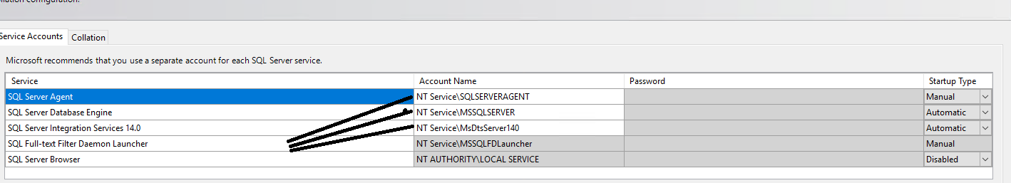

2025-09-24T12:16:06.22+00:00
Screenshot 2025-09-24 073457
I found a thread online that it was the 3 accounts(see attached), that I needed to change them to a windows account and it worked.

  1. Erland Sommarskog 134.7K Reputation points MVP Volunteer Moderator
    2025-09-23T20:39:51.3466667+00:00
    The error message about not finding the startup handle means that SQL Server did not start when Setup wanted to run a configuration step. The SQL Server errorlog can give a clue of why it did not start. Assuming a default installation, you find the errorlog in C:\Program Files\Microsoft SQL Server\MSSQL14.MSSQLSERVER\LOG\ERRORLOG, but depending on the options you selected when you ran Setup, the log file may be elsewhere.
    Feel free to attach it here. You will need to rename it to ERRORLOG.txt for the forum software to accept it.
