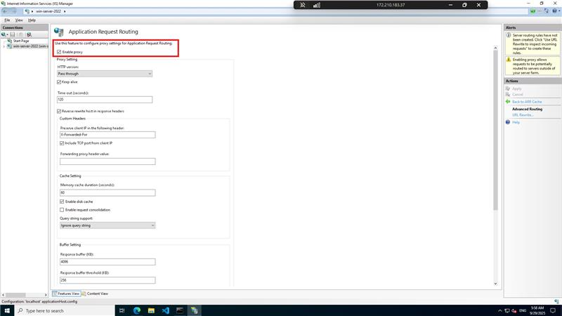

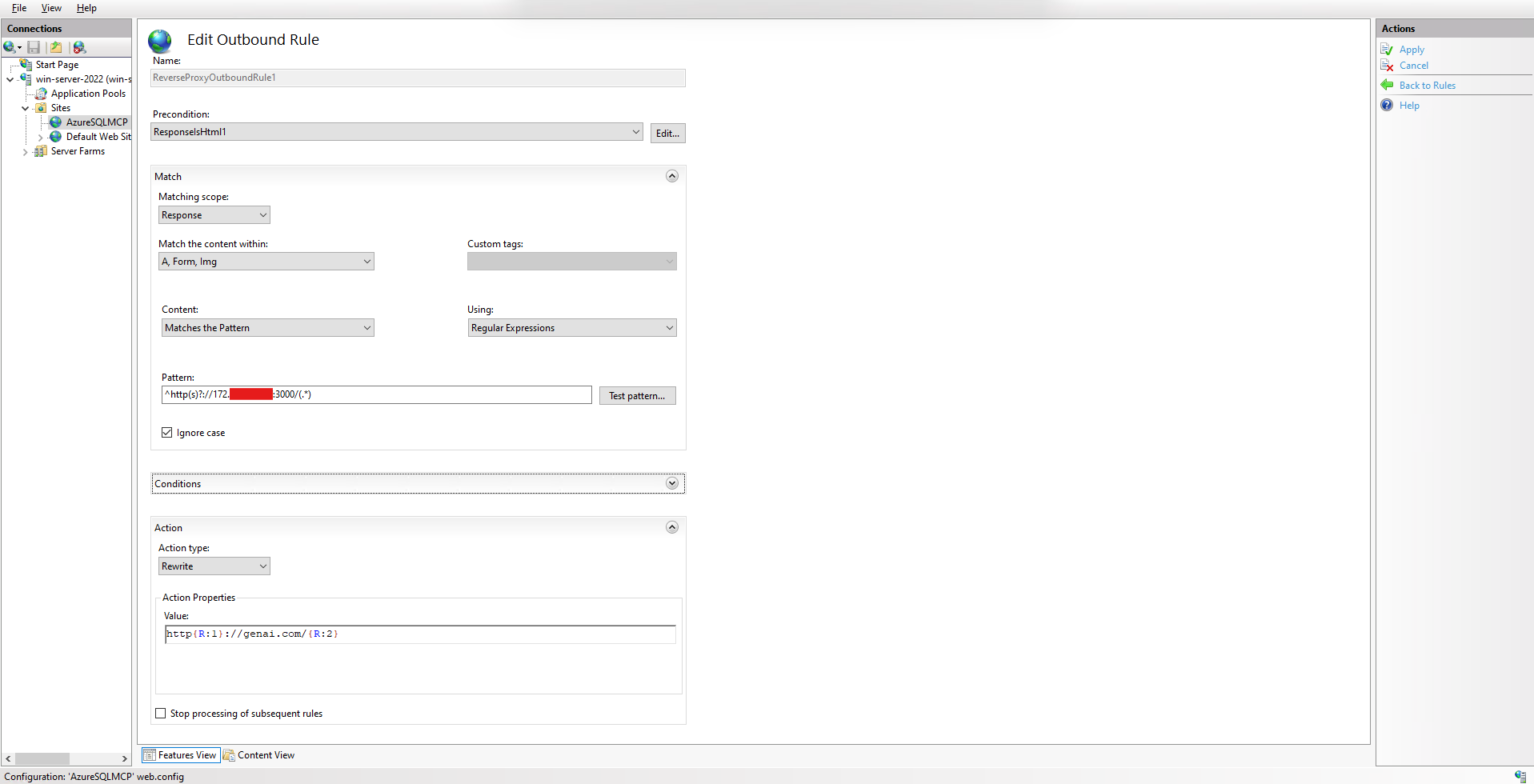

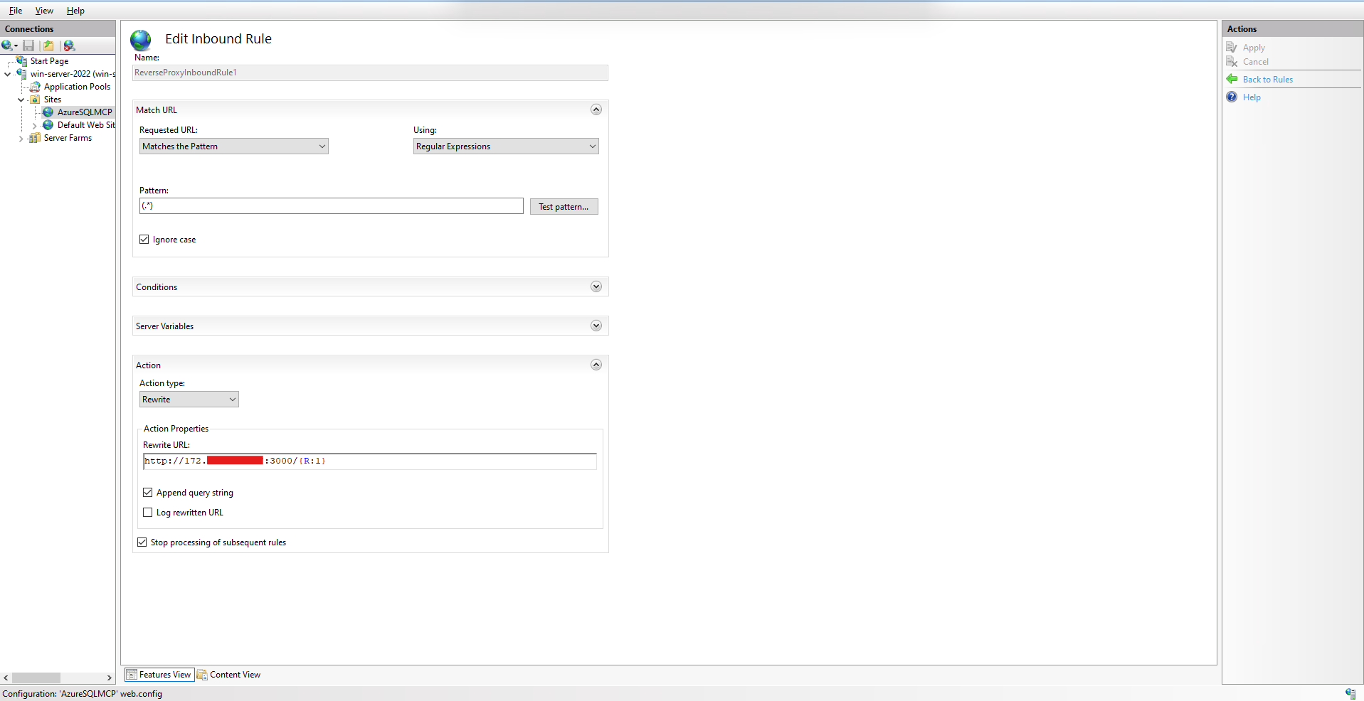

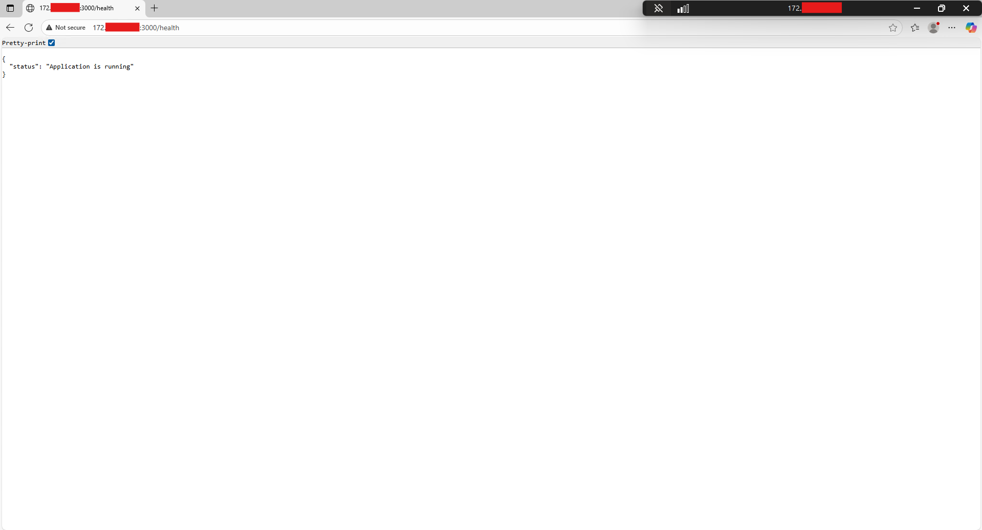

I have installed my python app as an nssm service which is running successfully in my remote machine with an IP of 172.xxx.xxx.xx and 7777 port . Then I opened the IIS and did the following steps: 0. I tested http://172.xxx.xxx.xx:7777 and it is working fine 1. I enabled Proxy in the server proxy settings in Application Request Routing 2. I created a new site named Python_App and added a folder named Proxy under the C:/inetpub/wwwroot/Proxy and left the others in it as such. 3. Then I created a new rewrite url inbound+ outbound rule. For the inbound rule, i entered 172.xxx.xxx.xx:7777 and entered the same in the from part of the outbound rule and the client had created a domain name lets call it genai.com and i entered that from the drop down which automatically showed in the to dropdown box. This worked for the first time, that is when i tried with port 3000 and hit the genai.com in my local machine's browser and it worked, and i deleted that and tried the same steps with the updated app in port 7777 but the url did not show the output but Hmmm… can't reach this page genai.com refused to connect.

    2. Can you confirm if "Enable Proxy" is checked in IIS Application Request Routing server proxy settings, and do you have the exact inbound and outbound URL rewrite rules configuration you applied for the genai.com site?

    Depending on the route of your app, your inbound rule should match all incoming requests to genai.com and rewrite them to http://172.xxx.xxx.xx:7777/{R:1} and Outbound rules should rewrite response URLs (e.g., from http://172.xxx.xxx.xx:7777 back to http://genai.com) if any absolute URLs are returned. The rewrite URL should be consistent with your current backend port (7777).

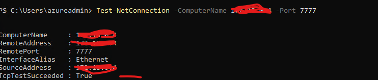

    Additonally, Test-NetConnection -ComputerName 172.xxx.xxx.xx -Port 7777 in PowerShell
    If successful, the port is reachable from the IIS server.User's image

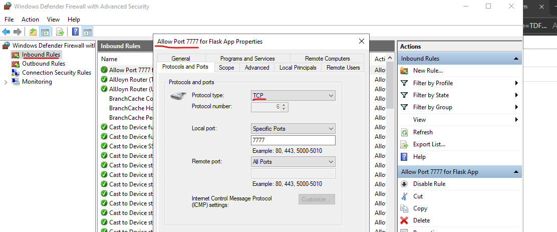

    Also check firewall settings on the machine hosting the Python app: and ensure inbound rule allows TCP port 7777.
