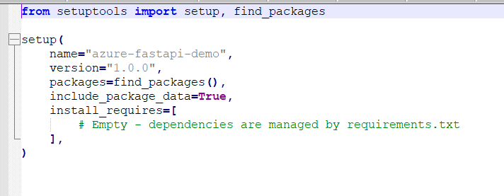

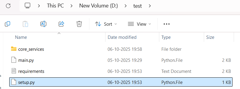

I am trying to deploy a Fast API python project on Azure App Service (Linux) through the Zip Deployment. It shows build successfull but getting the below error . I have set SCM_DO_BUILD_DURING_DEPLOYMENT to True, but still it is throwing the same error. I am using below command in startup command.
gunicorn -w 4 -k uvicorn.workers.UvicornWorker main:app
I am unablle to attach the zip folder here so added the image of the project folder structure.
User's image 2025_10_04_10-30-0-155_docker.log
So, I am requuesting to please help me here

    Check for requirements.txt: Make sure you have a requirements.txt file in your project root that lists all your dependencies. The build process needs this.
    Make ai_services a proper package: In your ai_services folder, create an empty file named __init__.py. This tells Python that the folder is a package.
    Create a setup.py file (The Key Fix): In your project root, create a setup.py file. This tells Oryx to install your local code as a package.
    from setuptools import setup, find_packages
    setup(
    name="your-app-name",
    packages=find_packages(),
    include_package_data=True,
    install_requires=[
    # List your main dependencies here, or rely on requirements.txt
    Re-deploy: Zip your project again, making sure it includes the new __init__.py and setup.py files, and deploy it.
    The setup.py file is the magic ingredient. It triggers Oryx to run pip install -e ., which installs your local project in "editable" mode, making the ai_services module discoverable.
