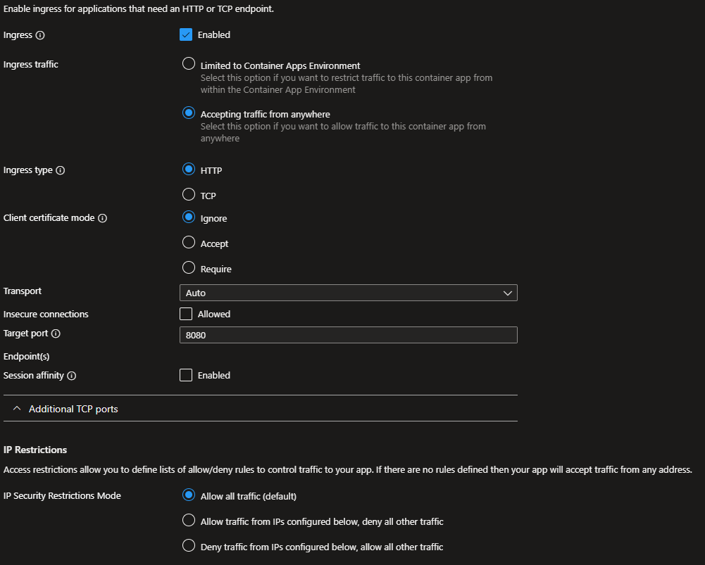

Hi all,
I'm running into an issue and i cant seem to find the right documentation. I'm trying to setup a Container App that needs to be publicly available but also needs to be able to get feedback from on-premise resources through a VPN.
I've done the following :
  1. Made 2 resource groups
    1. 1 for networking
    2. 1 for everything regarding the application/container app
  2. In my RG for networking i made :
    1. Virtual Network
    2. Address space
    3. Multiple subnets
  3. Public IP address
  4. VPN Gateway (which works)
  5. Local network gateway
  6. Connection
  7. Routing Table (connected to subnet allocated for container app)
    1. Made a route that sends on-prem traffic to the VPN gateway
  8. Network security group (connect to subnet allocated for container app)
    1. inbound & outbound rules that allow trafic to and from the on-premise subnets
  9. For my container RG i did the following :
    1. Made a container app environment thats connected to my vnet and dedicated subnet
    2. Made a container app with an image from github (works)
This is where i am stuck, i think i did everything correct and the VPN seems to work (says connected on both sides) but i dont see any traffic. The app is approachable but now i need it to be able to communicate with on-premise resources as well.
Does anyone know what i can/need to do now?
Thanks in advance!
