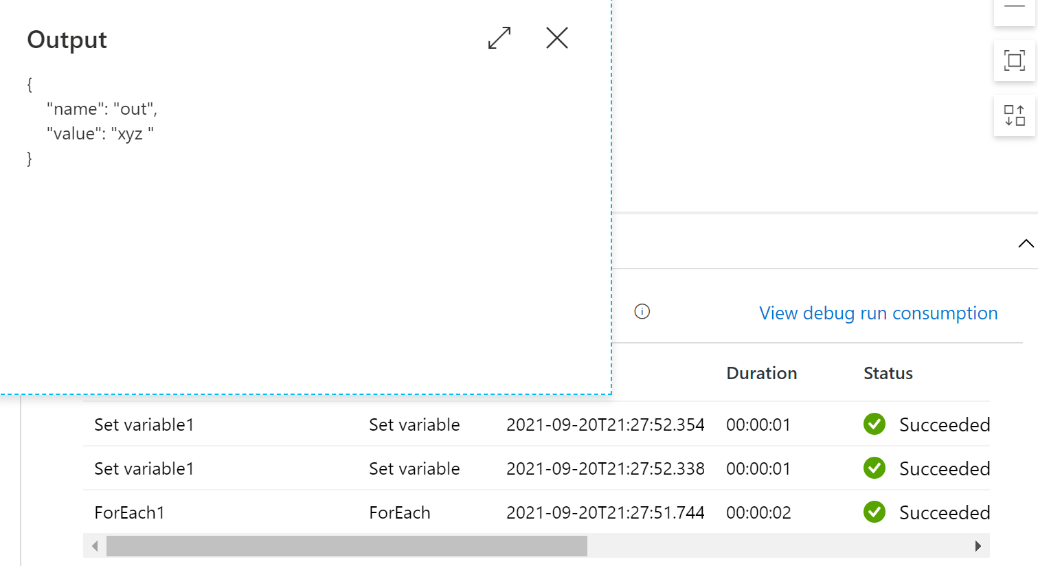

    Given sample data:
    {\"id\":\" https://abc.vault.azure.net/secrets/abc \",\"attributes\":{\"enabled\":true,\"nbf\":1632075242,\"created\":1632075247,\"updated\":1632075247,\"recoveryLevel\":\"Recoverable+Purgeable\"},\"tags\":{}},
    {\"id\":\" https://xyz.vault.azure.net/secrets/xyz \",\"attributes\":{\"enabled\":true,\"nbf\":1632075242,\"created\":1632075247,\"updated\":1632075247,\"recoveryLevel\":\"Recoverable+Purgeable\"},\"tags\":{}}
    and ForEach items expression:
    @json(replace(pipeline().parameters.sample_data,'\"','"'))
    and a Set Variable activity inside the loop with expression:
    @substring(item().id,
    add(lastindexof(item().id,'/'),1),
    sub(length(item().id), add(lastindexof(item().id,'/'),1))
    I get outputs abc , xyz
