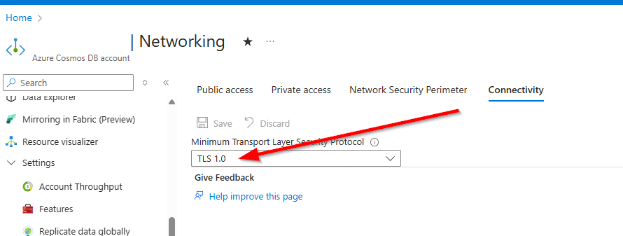

I have an old Function App that recently started crashing constantly with the following error:
  "code": "Forbidden",
  "message": "Connection is insufficiently secured. Please use Tls12 SSL protocol or higher, Protocol detected: Tls\r\nActivityId: af9eca58-9f76-43c8-8ccb-xxxxxxxxxxx, documentdb-dotnet-sdk/2.14.0 Host/64-bit MicrosoftWindowsNT/10.0.20348.0"
This function uses DocumentDB to connect to a CosmosDB instance within the same Azure subscription.
This is a legacy project that we only maintain, no new development is being done on it.
What could explain this new error? Everything was working perfectly fine until recently.
I double checked some settings, and my cosmosDB is still supporting TLS 1.0
So what explained that new error? And what can I do to get it working again?
Updating the code is not an option.
Thanks

  1. Shree Hima Bindu Maganti 7,420 Reputation points Microsoft External Staff Moderator
    2025-10-22T14:19:26.45+00:00
    Patrick Bolduc
    It appears your legacy Function App is having trouble because it doesn’t meet the newer TLS security requirements. The error suggests that TLS 1.2 or higher is now needed for connectivity.
    Microsoft is ending support for TLS 1.0 and 1.1 on Azure services, requiring TLS 1.2 by August 31, 2025. Although CosmosDB may still allow TLS 1.0, Azure changes could be restricting older protocol connections, which might explain your error.
    Since you can't update the code, it’s important that your app supports TLS 1.2. In .NET Framework, this typically means setting ServicePointManager.SecurityProtocol accordingly.
    If code changes aren’t possible,
    Try updating your DocumentDB SDK to a version that uses TLS 1.2 or higher, as older versions may not work with current security policies.
    Check your Azure Function App’s "TLS/SSL settings" to ensure everything is current, as compliance is necessary even if these settings mainly affect incoming requests.
    To help further, could you share:
    1. Which .NET Framework version your Function App uses?
    2. Whether you can review the codebase for potential TLS configuration workarounds?
    Retirement of TLS 1.0 and TLS 1.1 by August 31st 2025
    TLS 1.2 Enforcement on Cosmos DB
    Transport Layer Security (TLS) best practices with the .NET Framework
    Setting minimal TLS version for SQL database
    Let me know if you have any further assistances needed.

  1. Bruce (SqlWork.com) 84,061 Reputation points
    2025-10-20T16:13:36.26+00:00
    as announced 2 years ago, support for tls 1.0 was retired on 8/31/2025, so Cosmos DB no longer supports tsl 1.0.
    https://azure.microsoft.com/en-us/updates?id=update-retirement-tls1-0-tls1-1-versions-azure-services
    seems your server was finally updated. you will need to update the client code.
