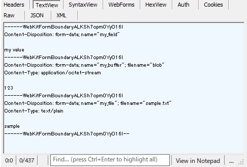

    First, please investigate if the form data are properly sent from the client to tha server. To do so, please use the Fiddler or equivalent tool to capture the data sent from the client to the server. For example when the following data are sent using ajax,
    const form = new FormData();
    form.append('my_field', 'my value');
    form.append('my_buffer', new Blob([1,2,3]));
    form.append('my_file', fileInput.files[0]);
    the contents captured by the Fiddler look like below:
    enter image description here
    Please obtain the captured result by yourself and verify if the data are properly sent.
