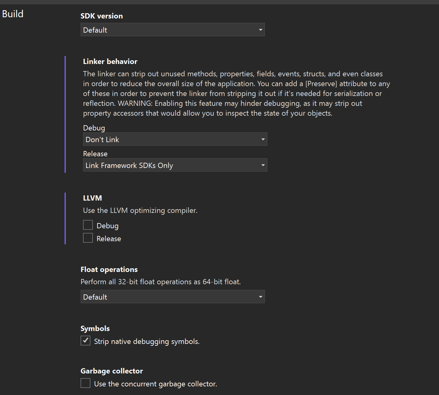

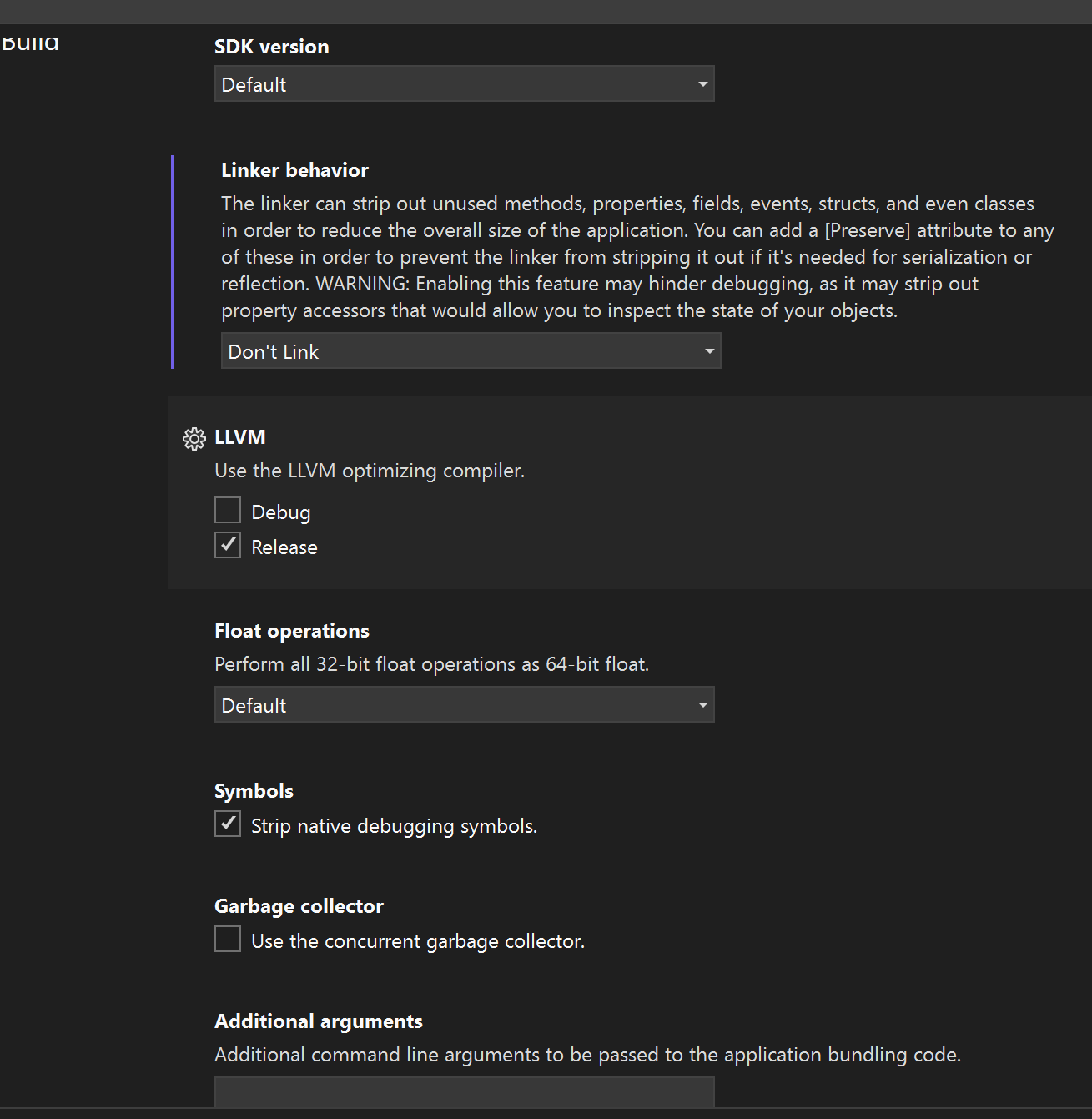

Hello @Kim Strasser ,
Please try this streamlined setup in your .csproj file. I have cleaned up a few conflicting settings (like the duplicate LLVM properties) and set the linker to None for the Release configuration.
- Close Visual Studio.
- Manually delete the
binandobjfolders in your project directory. - Replace your
.csprojcontent with the XML below. - Open the project and try to build again.

<PropertyGroup Condition="'$(Configuration)|$(Platform)'=='Debug|AnyCPU'">
<MtouchLink>SdkOnly</MtouchLink>
<DebugType>portable</DebugType>
<MtouchDebug>true</MtouchDebug>
<CodesignKey>iPhone Developer</CodesignKey>
<CodesignProvision>Project iOS Profile Development</CodesignProvision>
</PropertyGroup>
<PropertyGroup Condition=" '$(Configuration)|$(Platform)' == 'Release|AnyCPU' ">
<CreatePackage>true</CreatePackage>
<!-- Set Link to None to prevent the original crash and build errors -->
<MtouchLink>None</MtouchLink>
<Optimize>true</Optimize>
<UseLlvm>false</UseLlvm>
<CodesignKey>iPhone Distribution</CodesignKey>
<CodesignProvision>Project iOS Profile Distribution</CodesignProvision>
</PropertyGroup>
