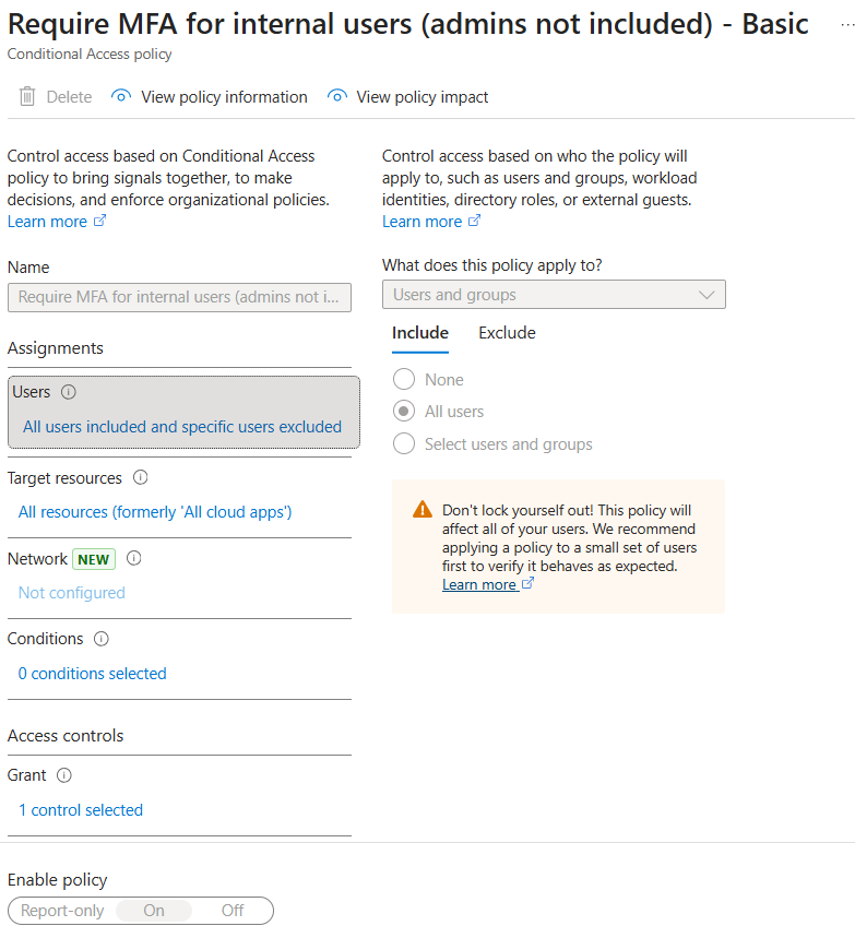

Hi, Recently, I have modified conditional access policy for internal users to require mfa i just excluded one users but after that users are keep on logging out which is also causing conditional access bypass alert on sentinel. I changed the CA policy again to setup sign in frequency to 30 days and checked the persistent browser session to always but it doesn't resolved my issues

    first of all our environment i all cloud and we are using Entra for access control only we are not managing devices from here. Secondly MFA scope is set to All cloud apps, its for outlook aswell. I noticed most of the failures are triggering by non interactive attempts. Regarding users a subset of users are facing this problem causing Sentinel to trigger alert "Attempt to Bypass Conditional Acesss in Entra ID" and most common error is "["50078: Other MFA required in Azure AD"," MFA required in Azure AD"]"
    Please help me out in this it is really getting frustrating because its almost three weeks i am hitting my head to resolve this
    Here is screenshots for my CA policy:
