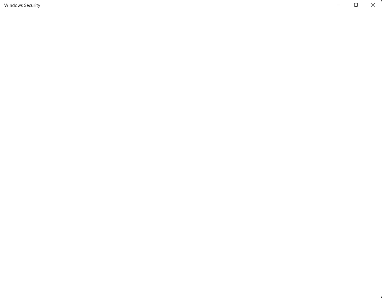

Hello,
My Windows Security platform on Windows 11 is completely broken after installing a malicious application. Here are the symptoms:
  1. When I try to open the Windows Security app from the Start Menu, it opens to a completely blank page.
When I go to the old Control Panel > Security and Maintenance and click "Turn on now" for virus protection, I get the error: "The Windows Security Center service can't be started."
I have checked the Services console (services.msc), and the "Security Center" service (wscsvc) is completely missing from the list, along with other core Defender services.
This issue started after I installed a game from an untrusted source, which I now know contained malware. The malware also appears to have removed my admin privileges, although my account is still listed as an administrator.
Troubleshooting steps I have already taken:
I successfully regained full admin privileges by activating the built-in administrator account and re-adding my own user account to the administrators group.
From an elevated command prompt, I have run both DISM /Online /Cleanup-Image /RestoreHealth and sfc /scannow. Both commands completed successfully, and sfc reported that it "found corrupt files and successfully repaired them."
Despite these repairs and multiple reboots, the issue persists. The Windows Security app remains blank, and the services are still missing.
My primary question is: Since the standard system file repair tools (sfc, DISM) did not restore the missing services, what is the official or recommended procedure to completely rebuild and reinstall the Windows Security platform on Windows 11?
Is there a way to do this without performing a PC Reset that would remove all my installed applications?

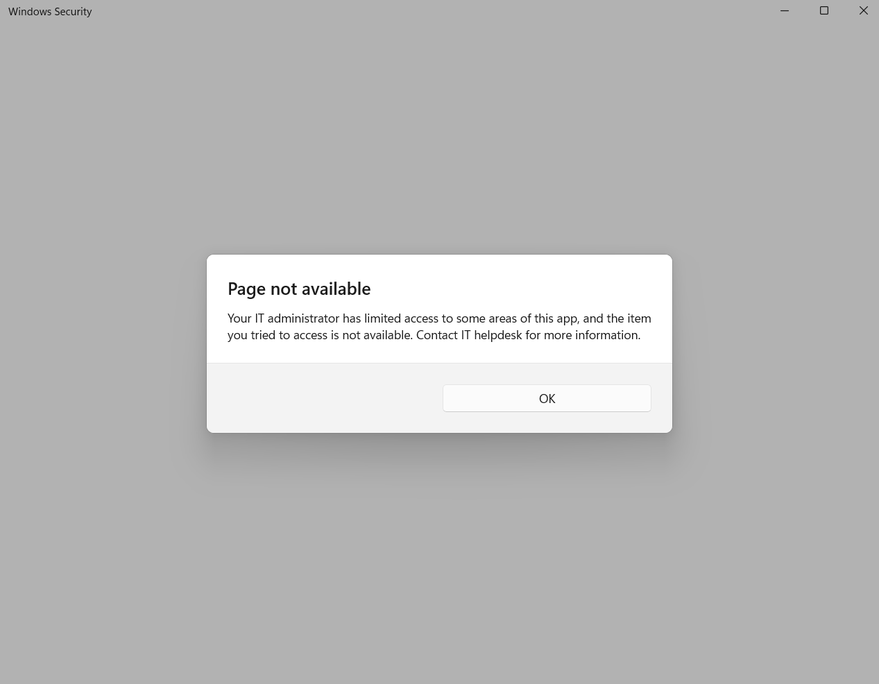

Thank you for your assistance. User's image
{962AF07F-BB4A-4FDB-86CC-C714C7E05434}
Windows for home | Windows 11 | Security and privacy
  1. Virginia M 41,560 Reputation points Independent Advisor
    2025-11-07T11:57:01.81+00:00
    Hello, I’m Virginia a fellow Windows user.
    Are you a home or business user? You screenshot show that your IT dept has limited access to Defender, so you’d need to contact them if you are a business.
