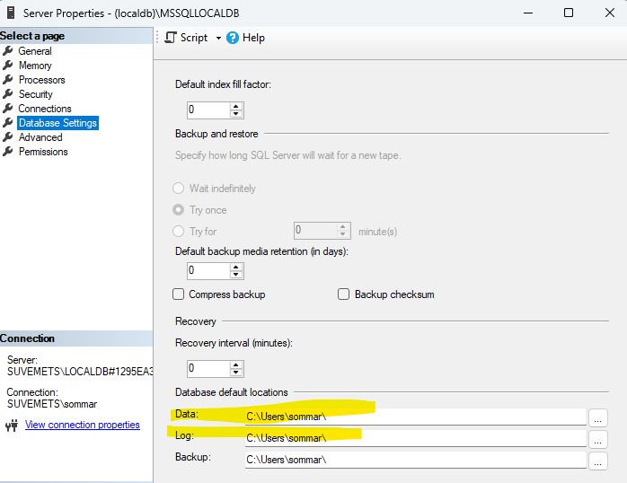

    To set the default directories, connect to the server in Object Explorer in SSMS, right-click the server itself and select properties. Go to the Database Settings page:
    I will need to add the disclaimer that I have not verified that this actually works for LocalDB.
