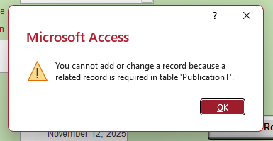

I have a combo box (PublicationCombo) in a subform that requires an entry before the record can be saved. I have the "Required" property in the corresponding table set to "Yes". The following VBA code is in the subform's property:
Private Sub Form_BeforeUpdate(Cancel As Integer)
If IsNull(PublicationCombo) Then
    Cancel = True
    MsgBox "Select a value from the dropdown menu."
    Me.PublicationCombo.SetFocus
End If
End Sub
From everything I've read and viewed, this should work; but it doesn't. I'm stumped as to why it doesn't work. Any ideas?
BTW, without the above code Access displays an error message so the record can't be saved, but the message is not in plain language. That's why I want to insert the message box and keep the focus on the field in question.

  1. Robert Walberg 5 Reputation points
    2025-11-17T18:54:46.65+00:00
    Ken & everyone else who contributed
    Happy to say I have solved the problem. The key was me studying and understanding what Ken said about Access setting a default value of zero in the bound table. Once I deleted the Default Value of "0" for all combo box fields (there are 3) and saved the changes, I was able to use the Before Update event as intended in the first place without using the On Error event. Not only that, but I was able to use IF/ElseIF to handle all three combo boxes in the subform. Now the user cannot leave the record without filling in the required fields. Setting the focus and displaying the dropdown menu should make the data entry idiot proof.
    BTW, deleting the Before Update event and inserting Ken's code in the On Error event didn't make a difference. Probably because the bound table default value = 0.
    Thank you to all of you. It wasn't a straight line, but I got there and learned a few things in the process.

  2. Duane Hookom 26,545 Reputation points Volunteer Moderator
    2025-11-12T11:44:57.69+00:00
    It might be easier to change the Form’s On Error message from the default to plain language. Sorry I’m not able to test this at the moment.
  3. George Hepworth 22,215 Reputation points Volunteer Moderator
    2025-11-12T12:04:21.41+00:00
    What, exactly is that cryptic error? Show us a screenshot of the actual error message, please.
  4. Karl Donaubauer 2,691 Reputation points MVP
    2025-11-12T13:33:45.0433333+00:00
    Your code doesn't look wrong.
    Can you explain that in more detail? What exactly are you doing to test this and what happens?
