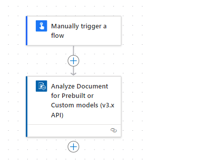

Hi all expert members in the community. Now I am trying to Azure AI documentation (custom model) to extract information form PDF file and auto comparing to standard which one save on onedrive, to auto generate inform that Pass or failed sample (results received via E mail). I have already finished training the Azure model, I am moving to the next steps, but when I try to call a connector Azure AI document in power automate, It was not found, but I was also looking for this way on Youtube, about 3 months ago, it still worked as the attached picture.
So please you help me, teach me which name of the Azure Document intelligent now to connect in power automate, or is there other way to connect this custom model in power automate with easiest way.

The Azure AI Document Intelligence connector (previously Form Recognizer) is still available in Power Automate, but it's listed under the new name "Azure AI Document Intelligence (form recognizer)"—search for that exactly in the connectors panel, or look under AI Builder > Document processing for prebuilt options. For custom models like yours (trained for PDF extraction and comparison), the built-in connector supports model IDs, but if it's not appearing or failing, the easiest integration is via HTTP actions calling the REST API directly—no extra custom connector needed. This works seamlessly with Power Automate's premium license and lets you pull extracted data for comparison against your OneDrive standard file, then email results (Pass/Fail).
Step 1: Verify/Find the Connector
  • In Power Automate > Create flow > Search "Azure AI Document Intelligence" or "Form Recognizer"—if missing, ensure your environment has AI Builder enabled (Admin center > Environments > Your env > Settings > Features > AI Builder > Turn on).
  • If still not there: Use the HTTP action (premium) for API calls—more flexible for custom models anyway.
