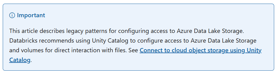

    This is expected behavior on Unity Catalog-enabled clusters. For security and compliance, Unity Catalog blocks settings like fs.azure.account.key. These configurations are stripped, so the ABFS driver cannot find them.
    Correct approach:
    • Do not use spark.conf.set with account keys.
    • Instead, create a Unity Catalog Storage Credential backed by a managed identity (recommended) or service principal, then define an External Location pointing to your ADLS Gen2 container.
    • Grant permissions on the external location to catalogs, schemas, or users, and access data via tables, volumes, or managed locations.
    Legacy pattern (fs.azure.account.key) works only on non-UC clusters. For UC-enabled workspaces, the supported method is Storage Credentials + External Locations.
