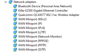

    I had to dig on multiple forums, but I found a solution, which was to uninstall Killer (the program for the ethernet network card) from the add/remove programs section.

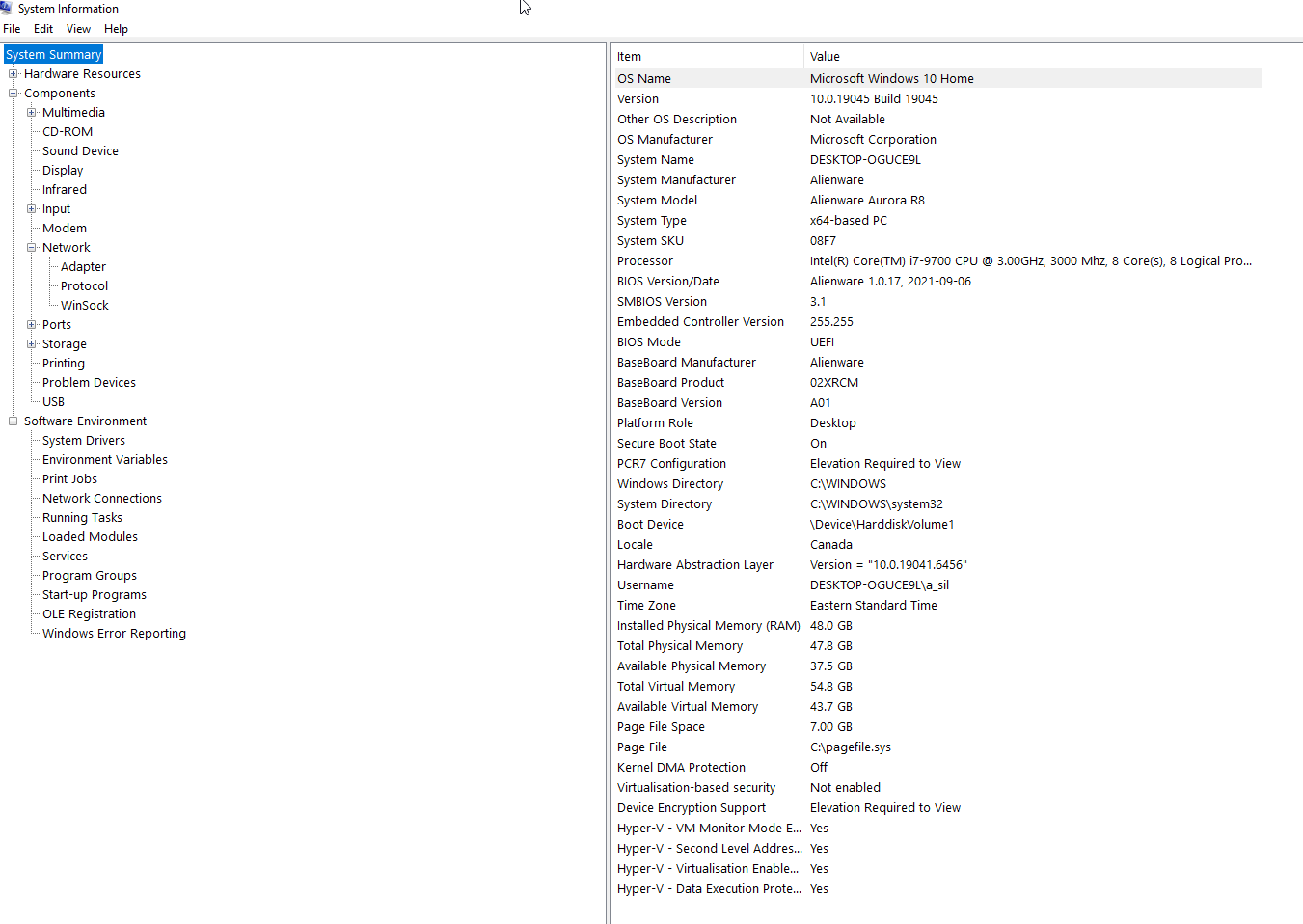

    Specify the exact computer model or motherboard model, or go to Start, type msinfo in the search box, and attach a screenshot of the System Information page.
    Right-click Start > Device Manager, expand Network Adapters, and post a screenshot.
