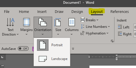

    If this issue only occurs with Word documemts, I suggest you go to Layout tab > Orientation, check whether it is the same as the one you set for printing.
    And then, you could also search "Printer & Scanners" > Find your printer, click Manage button > Printing Preferences, please also ensure the orientation is your needs.
