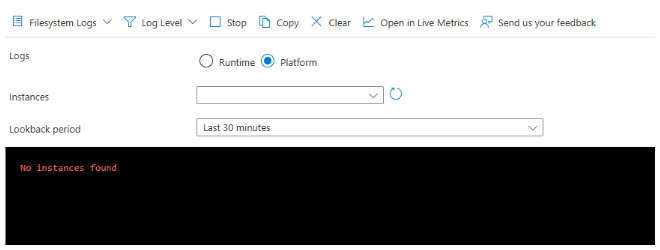

When I go into filestream, the below is what I see. No instances. Switch to application insights, just says connected, no logs.

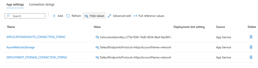

    Ensure that you have the correct Application Insights Instrumentation Key or Connection String set up in your application settings.

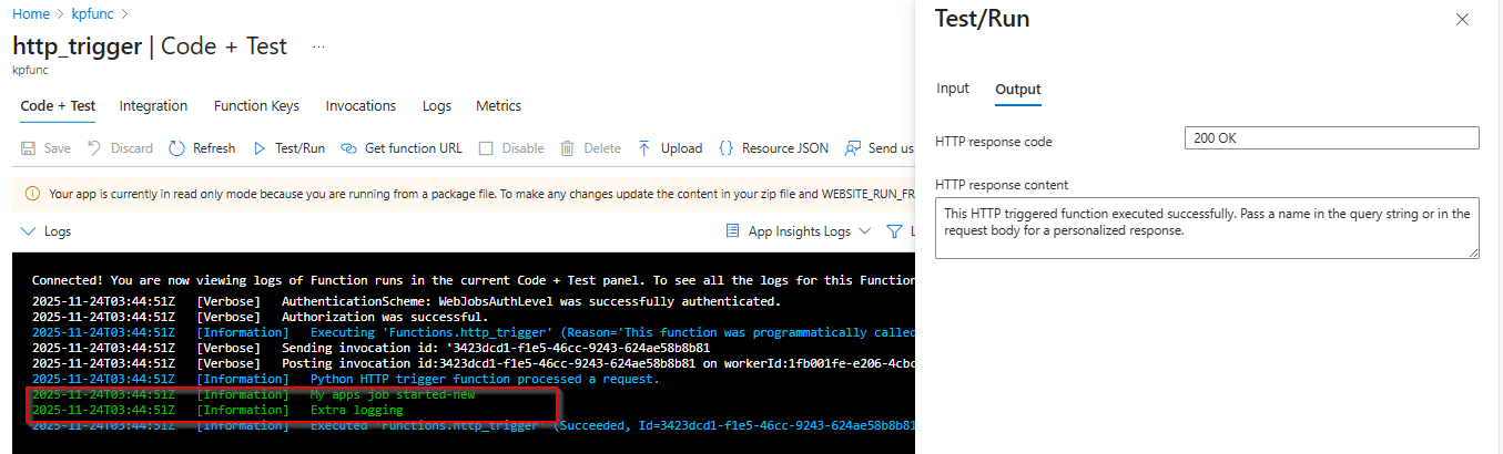

    I have tested the same with below configuration, and it worked.
    Sample code:
    import azure.functions as func
    import logging
    app = func.FunctionApp(http_auth_level=func.AuthLevel.ANONYMOUS)
    @app.route(route="http_trigger", auth_level=func.AuthLevel.ANONYMOUS)
    def http_trigger(req: func.HttpRequest) -> func.HttpResponse:
        logging.info('Python HTTP trigger function processed a request.')
        name = req.params.get('name')
        if not name:
            try:
                logging.info('My apps job started-new')
                req_body = req.get_json()
            except ValueError:
                pass
            else:
                name = req_body.get('name')
        if name:
            return func.HttpResponse(f"Hello, {name}. This HTTP triggered function executed successfully.")
        else:
            logging.info('Extra logging')

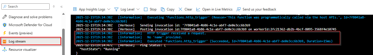

    LogStream:
    Open LogSteam and run the function parallelly.
    Connected!
    2025-11-24T04:00:38Z   [Verbose]   Request successfully matched the route with name 'http_trigger' and template 'api/http_trigger'
    2025-11-24T04:00:38Z   [Information]   Executing 'Functions.http_trigger' (Reason='This function was programmatically called via the host APIs.', Id=fb410169-43ec-473b-93f3-bdaa667cd070)
    2025-11-24T04:00:38Z   [Verbose]   Sending invocation id: 'fb410169-43ec-473b-93f3-bdaa667cd070
    2025-11-24T04:00:38Z   [Verbose]   Posting invocation id:fb410169-43ec-473b-93f3-bdaa667cd070 on workerId:e4acff6c-47bd-40fa-95cc-28353c688f98
    2025-11-24T04:00:38Z   [Information]   Python HTTP trigger function processed a request.
    2025-11-24T04:00:38Z   [Information]   My apps job started-new
    2025-11-24T04:00:38Z   [Information]   Extra logging
    2025-11-24T04:00:38Z   [Information]   Executed 'Functions.http_trigger' (Succeeded, Id=fb410169-43ec-473b-93f3-bdaa667cd070, Duration=42ms)
