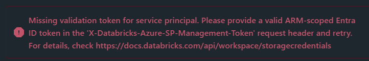

Facing below error message when trying to create a storage credential in Databricks

Getting above message when trying to create a storage credential under Databricks, i am not sure how to proceed, please assist.

    Kiran Akella - Thanks for the question and using MS Q&A platform.
    If your Azure user account shows #EXT# in the User Principal Name (UPN), you’re using a guest account in Microsoft Entra ID. Databricks cannot validate ARM tokens from guest accounts when creating external storage credentials.
    Step1: Check if you’re a guest user
    • Go to Azure Portal → Microsoft Entra ID → Users → Your Account → Properties.
    • Look at User Principal Name. If it contains #EXT#, you’re on a guest account.
    Step2: Switch to the correct tenant
    • Use the tenant that owns your Azure resources (not the guest one).
    • Or use a non-guest user for that tenant.
    Step3: Sign in to Databricks with the right tenant
    Step4: Retry creating the storage credential
    Now, create the external credential again under the correct directory.
    Hope this helps. Let me know if you have any further questions or need additional assistance. Also, if these answer your query, do click the "Upvote" and click "Accept the answer" of which might be beneficial to other community members reading this thread.

    Thank you PRADEEPCHEEKATLA for providing a clear and helpful solution to this storage credential issue in Databricks. Your step-by-step guidance on checking guest account status and switching to the correct tenant is spot on.
    I'd like to add a couple of important points that might help others facing this issue. The underlying reason guest accounts (#EXT#) fail during storage credential creation is that Databricks needs to validate Azure Resource Manager (ARM) tokens against the home tenant, which guest accounts cannot properly authenticate against. If you're unable to switch tenants immediately, another option is to have your Azure administrator grant you direct permissions in the resource tenant instead of using guest access.
    Also, when you see error messages mentioning "Invalid ARM token" or "Authentication failed for storage credential," this is typically the root cause. After switching to the correct tenant, you may need to clear your browser cache or use an incognito window to ensure Databricks picks up the new authentication context properly.
    If the issue persists even after following these steps, it might be worth checking with your Azure administrator to ensure the Databricks workspace has the necessary permissions configured at the subscription level.
    Thanks
    Pratyush

    looks like a new azure account root account will now get created with #EXT and hence we need to create a new user logged as root user. Once done we need to grant subscription to the user as well as the Global administrator role to the user. Granting subscription was a bit challenging and I finally ended up using the CLI to successfully grant the subscription, without granting the subscription this new user will not be able to create any new resources as it is marked as reader and to create a resource this user must be either an Owner, or Contributor.
    Once the global administrator role as well as subscription was added was able to create the resource successfully.
    CLI Command
    az role assignment create \
      --assignee <object-id-of-new-user> \
      --role Owner \
      --scope /subscriptions/<subscription-id>
    example:
      --assignee 3232e3bf-62be-4729-562c5d59dd76 \
      --role Owner \
      --scope /subscriptions/7fe2ead8-090e-4912-d6baf3100b72 the output of the above command will be in a JSON format.
