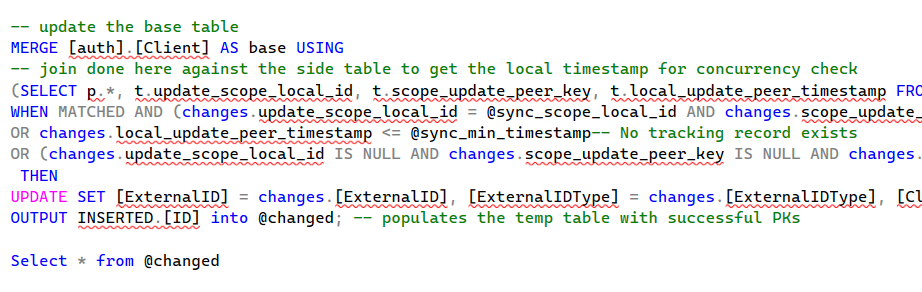

I already configured column and table in sync group but data is only updating when I execute SQL query manually but If I performed scenario from .NET application then sync is not working (.NET Framework with EF). I checked that azure sql trace and found that insert query but nothing updated in HUB db table. I execute the query on Member DB table.
Here is the insert query i can see in SQL trace (from HUB db Server):
declare @p3 DataSync.Client_dss_BulkType_98087373-6da6-4ec4-88d9-31992cc20798
insert into @p3 values('BC3BD3A3-132B-4F93-8076-93E0332D3D19','A87E9A3A-E4A0-4121-BE07-DFB0E9D245BC',N'VendorID',N'Demo_Provider_AP_TEST222',N'http://localhost.com',NULL,NULL,N'V2',NULL,NULL,NULL,NULL,NULL,NULL,1,0,0,NULL,'2026-11-19 21:49:24.0230000',N'confidential',N'native',N'Created via Dev Portal ',1,'2025-11-19 21:49:24.0230000',NULL,'2025-11-21 16:53:08.6770000',NULL,2,0,N'DowntownClient',N'Provider',NULL,40476678,1,39747042,1)
exec [DataSync].[Client_dss_bulkupdate_98087373-6da6-4ec4-88d9-31992cc20798] @sync_min_timestamp=1327624444,@sync_scope_local_id=21,@changeTable=@p3
I think update triggered is fired that's why it is showing insert query on SQL trace so apart from this, Is there thing I need to verify ?
