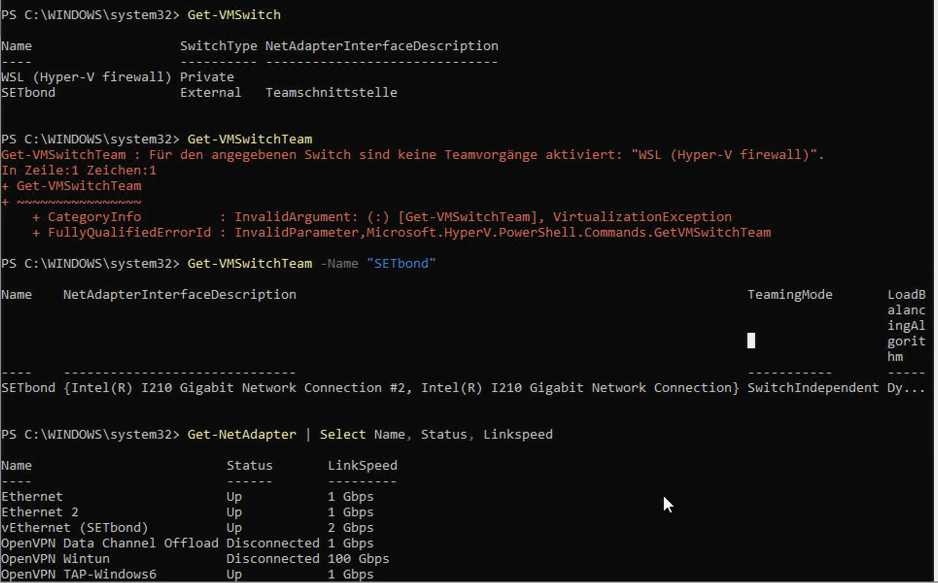

I want to add a virtual switch for my Hyper-V I am hosting. This virtual switch unfortunately doesn't work for my current setup:
  • NIC Teaming activated, LACP Bond for "Ethernet" and "Ethernet 2" with a dynamic load balancing.
    Trying to add the virtual switch to this bond outputs the following (translated from german):
    """Error applying virtual switch properties
    Error adding connections for the virtual Ethernet switch.
An LBFO team cannot be attached to a virtual Hyper-V switch. If teaming is required, use "New-VMSwitch" to create a Switch Embedded Team (SET). For more information, see: https://go.microsoft.com/fwlink/?linkid=2185083 """
I checked out the link, cleaned the network configs with
netcfg -d
and got to work setting everything up.
My commands were as follows:
New-VMSwitch`` ``-Name`` ``$SwitchName`` ``-NetAdapterName`` ``$NIC1Name``,``$NIC2Name`` ``-EnableEmbeddedTeaming`` ``$true`` ``-AllowManagementOS`` ``$true`` ``-Confirm``:``$false
Set-VMSwitchTeam`` ``-Name`` ``$SwitchName`` ``-TeamingMode`` SwitchIndependent``-LoadBalancingAlgorithm`` Dynamic
New-NetIPAddress`` ``-InterfaceAlias`` ``$vEthernetName`` ``-IPAddress`` ``$IPAddress`` ``-PrefixLength`` ``$PrefixLength`` ``-DefaultGateway`` ``$Gateway
Set-DnsClientServerAddress`` ``-InterfaceAlias`` ``$vEthernetName`` ``-ServerAddresses`` ``$DNS1``,``$DNS2
Unfortunately, not even a restart of my server after this setup managed to establish a connection.
I also tried the Set-VMSwitchTeam with -Teamingmode LACP, but that yielded an error along the lines of:
"""The value LACP can not be convertet do VMSwitchTeamingMode.""" (I don't know the exact wording anymore)
Does anyone know how to fix this? I need my host and my VM to have a stable internet connection and I don't care how I can get there.

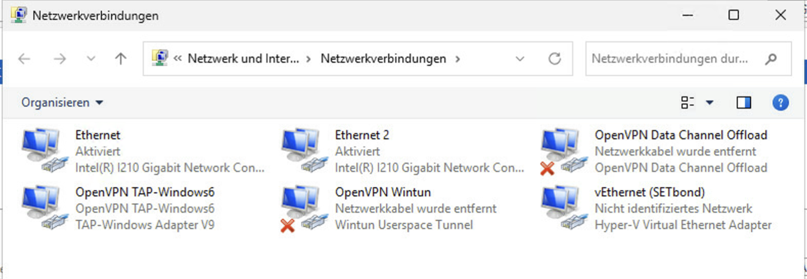

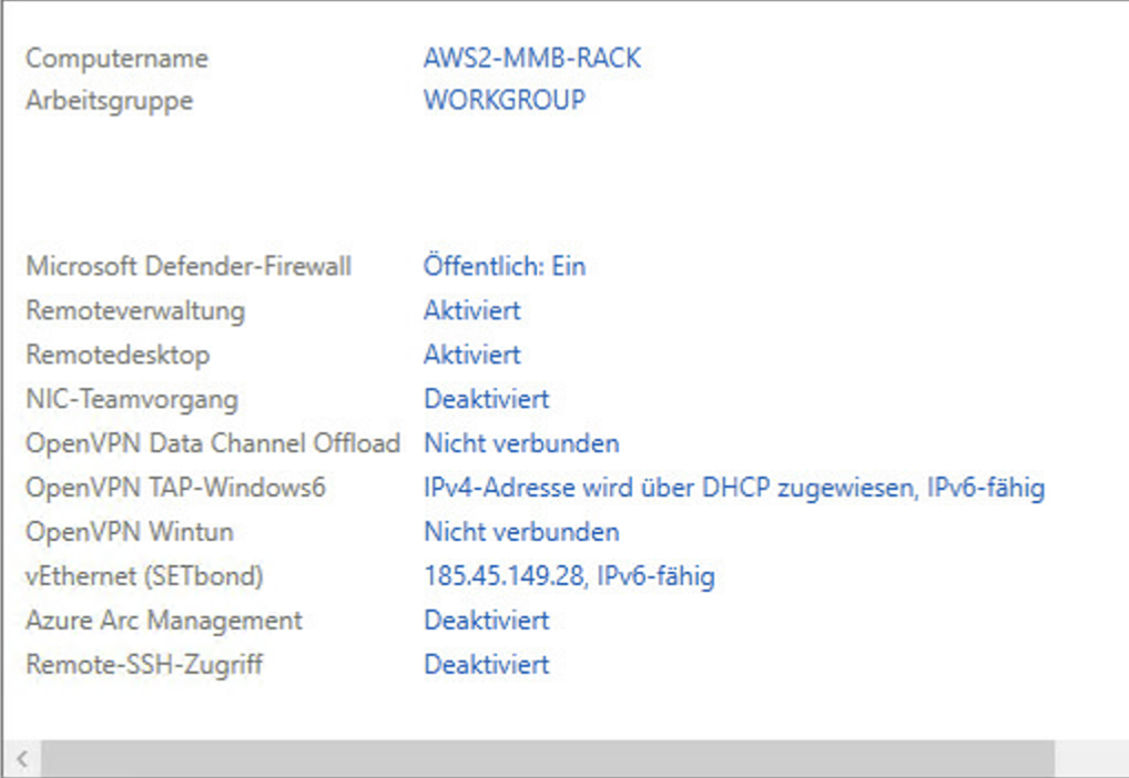

  5. Nam Bui (WICLOUD CORPORATION) 625 Reputation points Microsoft External Staff Moderator
    2025-12-02T02:50:59.2366667+00:00
    Hi Fabian,

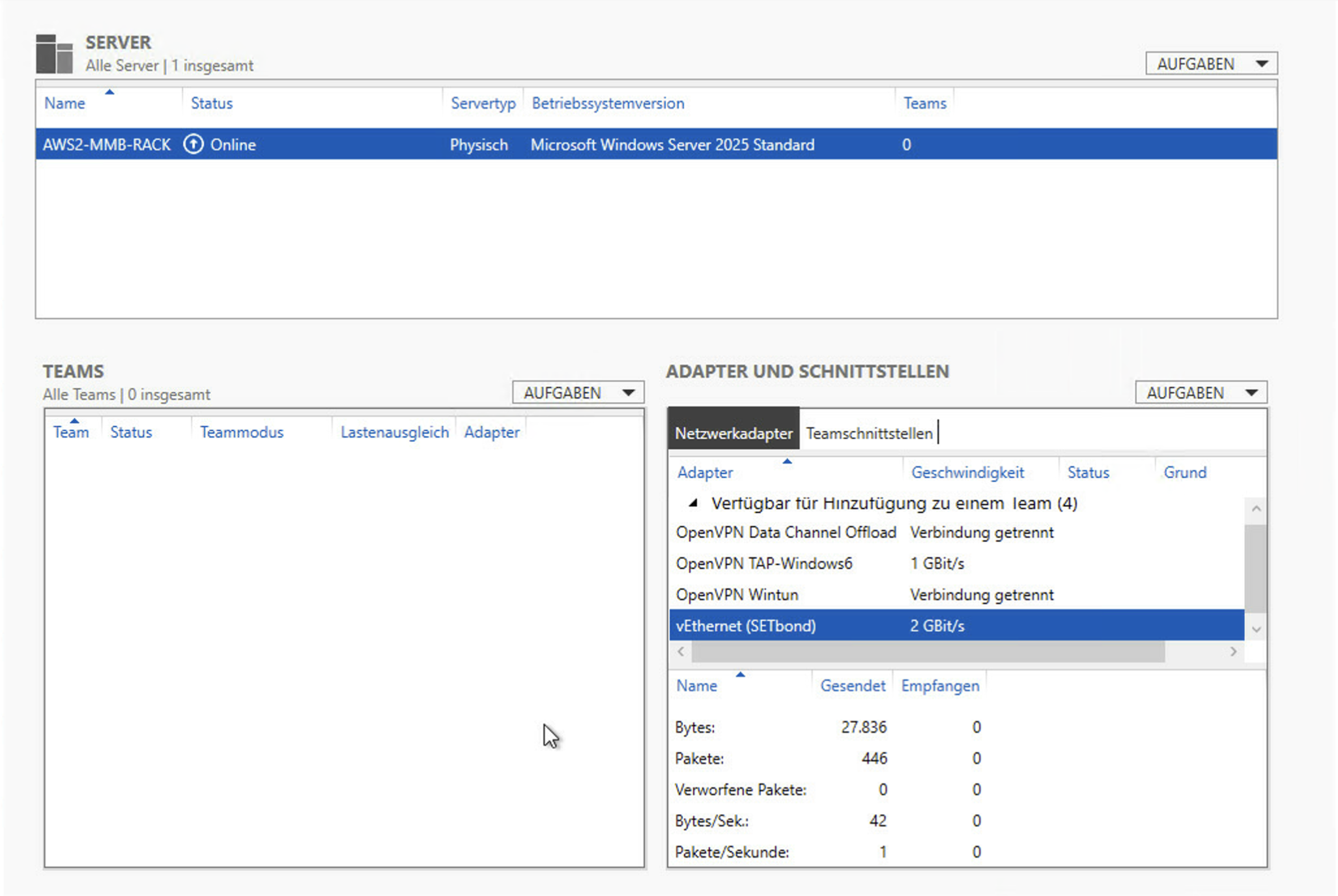

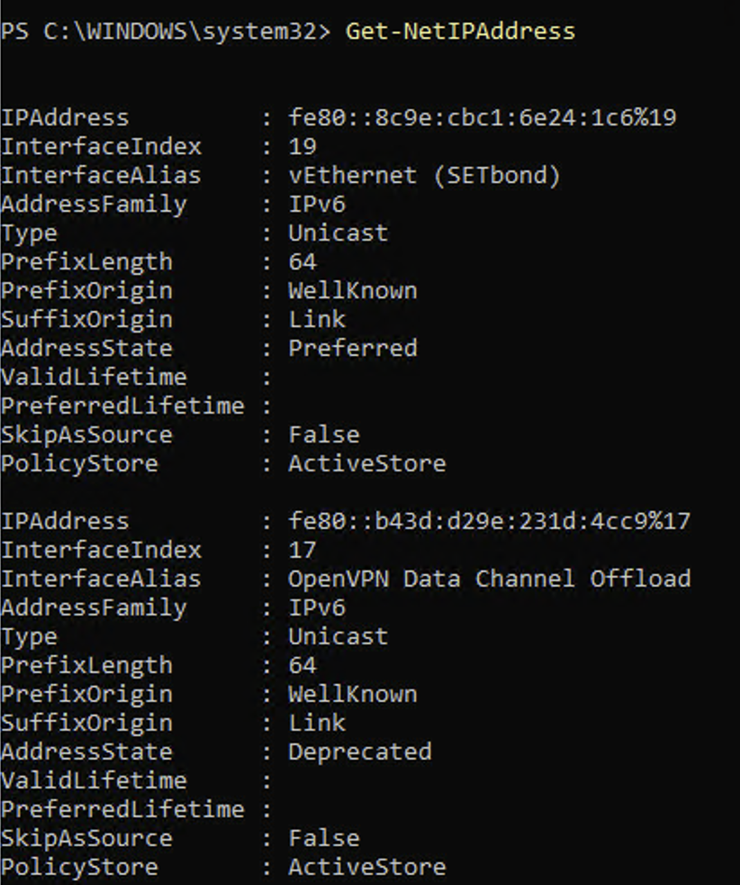

    Thanks for following the steps to remove the LBFO team. Before we continue with deeper troubleshooting on the SET switch, I need to confirm that the old LBFO configuration has been fully removed at the OS level. Sometimes the LBFO service leaves behind team objects even if they no longer appear in the GUI, and this can block the SET vSwitch from passing traffic.
    To make sure everything is clean, could you please provide the following screenshots?
    1. PowerShell output
    Please run:
    Get-NetLbfoTeam
    Get-NetLbfoTeamNic
    And send me a screenshot of the result. Expected: Both commands should return no objects (blank result).
    2. Server Manager - Nic Teaming
    From: Server Manager → Local Server → NIC Teaming Please capture the section showing that:
    • NIC Teaming = Disabled
    • No LBFO teams listed
    3**. Network Connections**
    Please open ncpa.cpl and send a screenshot of all network adapters. I want to verify:
    • No “Team” or “LBFO” virtual adapters remain
    • Only the two physical NICs + the SET vEthernet adapter
    Once I have these screenshots, I can confirm whether the LBFO was fully removed. This will help avoid false assumptions and ensure we troubleshoot the real root cause of the “No Internet” issue on the SET switch.
