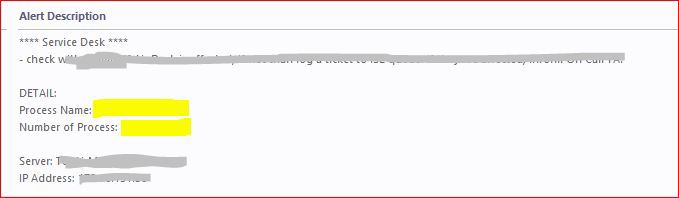

Basic how to question hoping someone can help me with. Trying to show number of running Process for a Process Monitor but when i use the ActiveInstance Count parameter it asks for a STRING value to be supplied.
I thought it was the actual "process name" but that doesnt work and the alert comes up blank for Instance Count.
Can someone tell me what is required here:
ProcessInstance Count

    You’re on the right track – the ActiveInstanceCount value is correct, it’s just the XPath that needs one more piece.
    The ProcessInformationProvider returns a set of processes under:
    ProcessInformations/ProcessInformation
    Each ProcessInformation node has a ProcessName and an ActiveInstanceCount. Because there can be more than one process, SCOM adds this placeholder:
    [ProcessName=<STRING>]
    to tell you “filter this collection by a string value”.
    You need to replace <STRING> with the actual process name in quotes (XPath string comparison), for example:
    $Data/Context/ProcessInformations/ProcessInformation[./ProcessName='myprocess.exe']/ActiveInstanceCount$
    Key points:
    • Keep the [ ./ProcessName = '…' ] part – the ./ and single quotes are important.
    • Just putting ProcessName=myprocess.exe without quotes will result in no match, so the alert text shows a blank value.
    • Use the exact name that the monitor is configured for (including .exe if that’s how you defined it).
    After you change your alert description to something like:
    Process 'myprocess.exe' is running $Data/Context/ProcessInformations/ProcessInformation[./ProcessName='myprocess.exe']/ActiveInstanceCount$ times.
    the alert should display the correct instance count.
