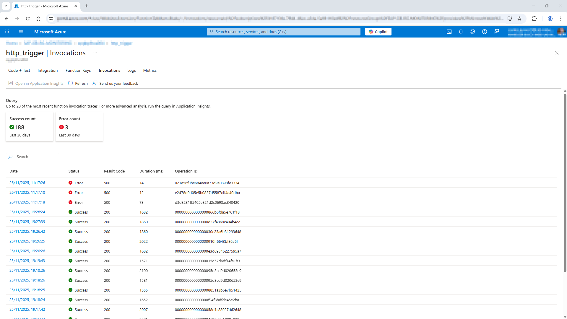

Hi! I have activated Application Insights for a function app and then I could see its invocations, as shown:User's image
However, when I changed the configuration in Diagnostic Setting to ingest logs from the same function to a Log Analytics workspace, it stopped working. As you can see, the last register was from 25/11/2025 19:28:24, then there were some other register from manual calls, but this function is being called multiple times and there is nothing to see there. Here is my Diagnostic setting screen:

  1. Rakesh Mishra 4,030 Reputation points Microsoft External Staff Moderator
    2025-11-27T15:44:27.7566667+00:00
    Hi @Rosa Junior, Carlos ,
    Welcome to the Microsoft Q&A Platform! Thank you for asking your question here.
    Could you please modify host.json by removing/commenting as below and share if it works. Could you please confirm if using inProcess or Isolated function app.
      "version": "2.0",
      "logging": {
        "applicationInsights": {
          "samplingSettings": {
            "isEnabled": true,
            "excludedTypes": "Request"
          "enableLiveMetricsFilters": true
      "extensionBundle": {
        "id": "Microsoft.Azure.Functions.ExtensionBundle",
        "version": "[4.*, 5.0.0)"
