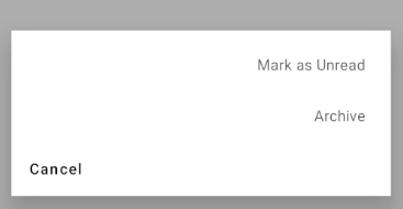

Issue 2: When we click on more icon it shows 2 options like below, it is right aligned, it should be aligned to left.
b
