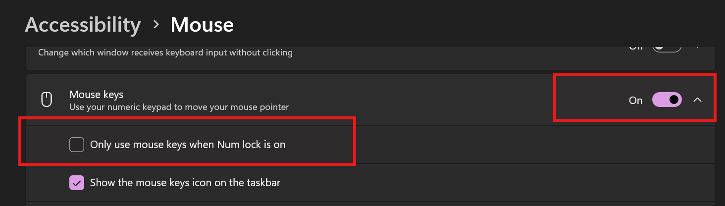

    Hi Elias Cosio, I want to ask that when the number keys of the pad don't work, do the arrow keys? (e.g. when pressing 4, instead of the number, the typing pointer going left). If they still function, then some settings might be incorrect, we just need to figure out which one.
    • Open Settings > Accessibility > Mouse > Mouse keys
    • Turn off Only use mouse keys when Num lock is on option
    • Toggle on/off the Num Lock key on your keyboard a few times
    • You can also try with Mouse keys off if it's already on
    • Open a quick typing page (e.g. Notepad) and test with each change you make

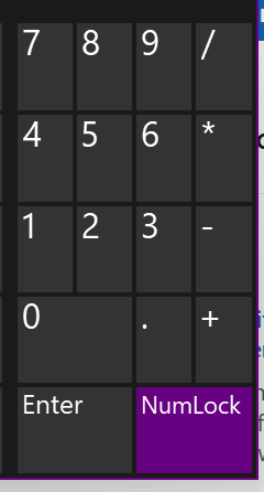

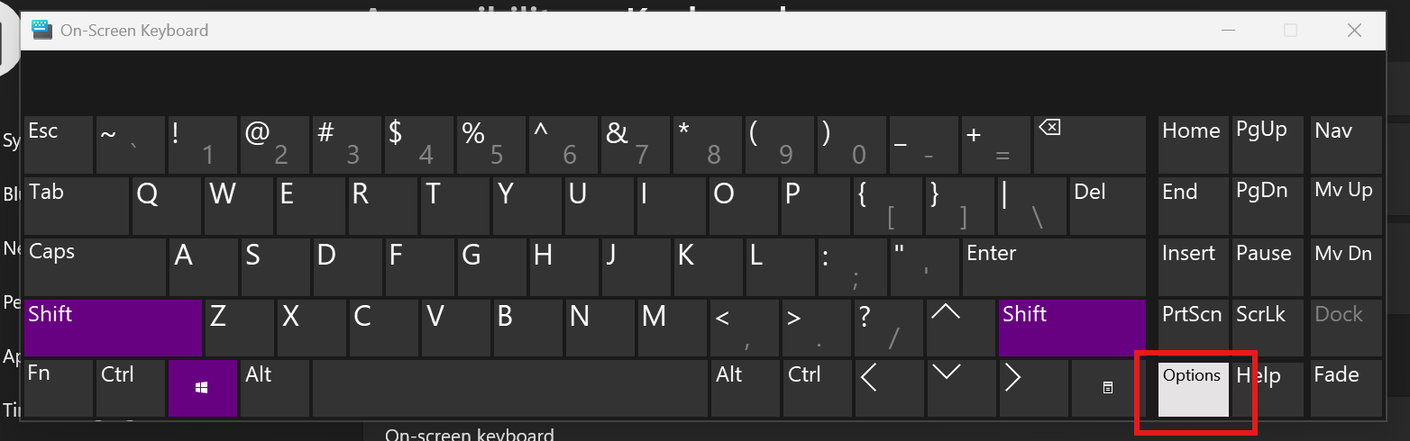

    If that still doesn't work, still in Accessibility, open Keyboard and turn ON On-screen keyboard to test. On that keyboard, click Options: User's image
    • In the opened window, check Turn on numeric keyboard User's image
    • Click the NumLock key and test the numpad keys on-screen
    • If it works, test with your built-in keyboard to see if the keys registered.
