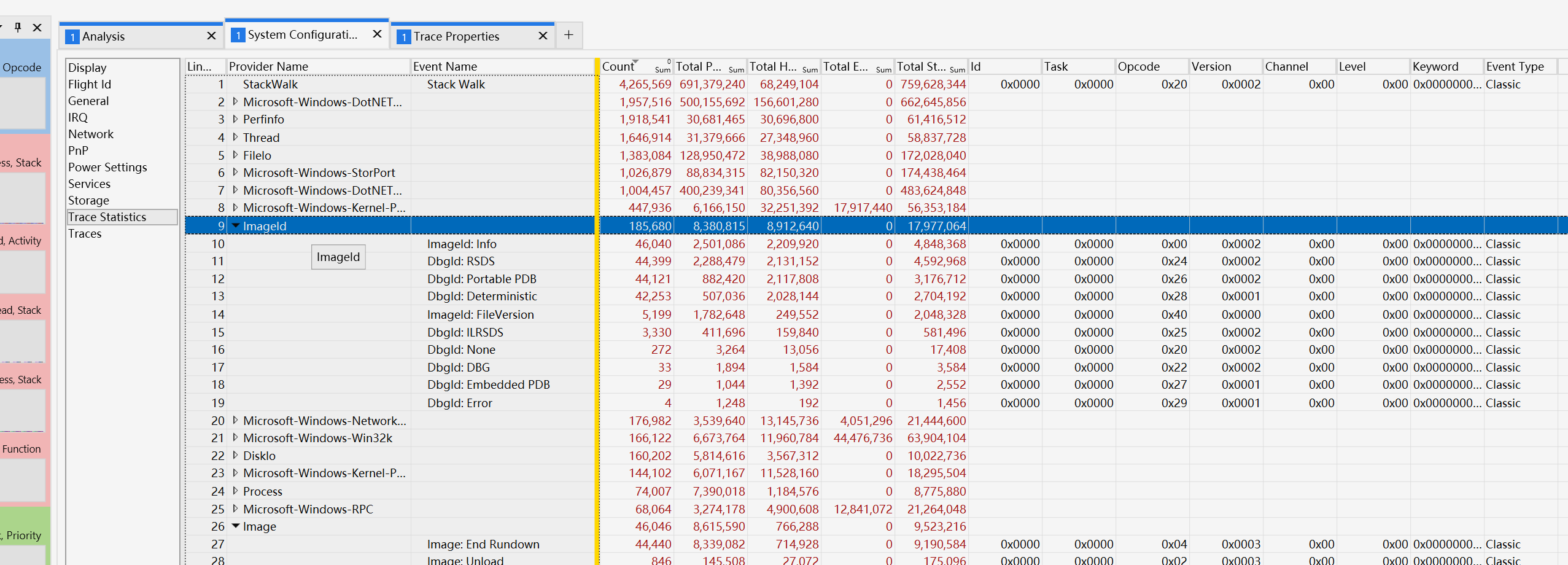

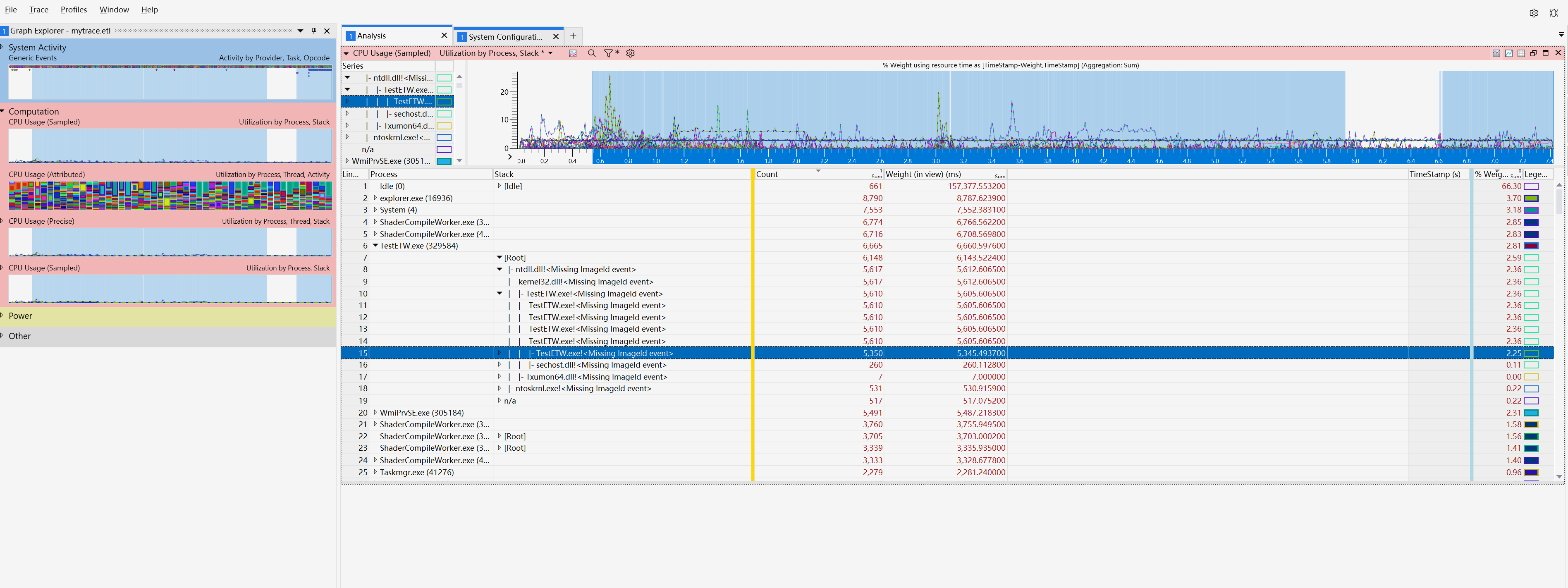

However when analyzing the etl file this program generated, Stack column shows "Missing ImageId event".
I noticed there is a provider named "ImageId" in the etl file recorded by WPR.
The problem is how can I enable this provider programmatically?

    That "provider" is not actually a provider and can therefore not be enabled. The "events" of that provider are fabricated and injected by WPR at the send of a trace (if the CustomEvents element of the TraceMergeProperties element in the WPR profile includes the CustomEvent ImageId).
    If your .etl file contains Image Start/DCStart/DCEnd events, you can use WPR to inject the additional image events into the file. Issue the command "wpr -help stop" and read about the command "wpr -merge" and the "-injectonly" option.
