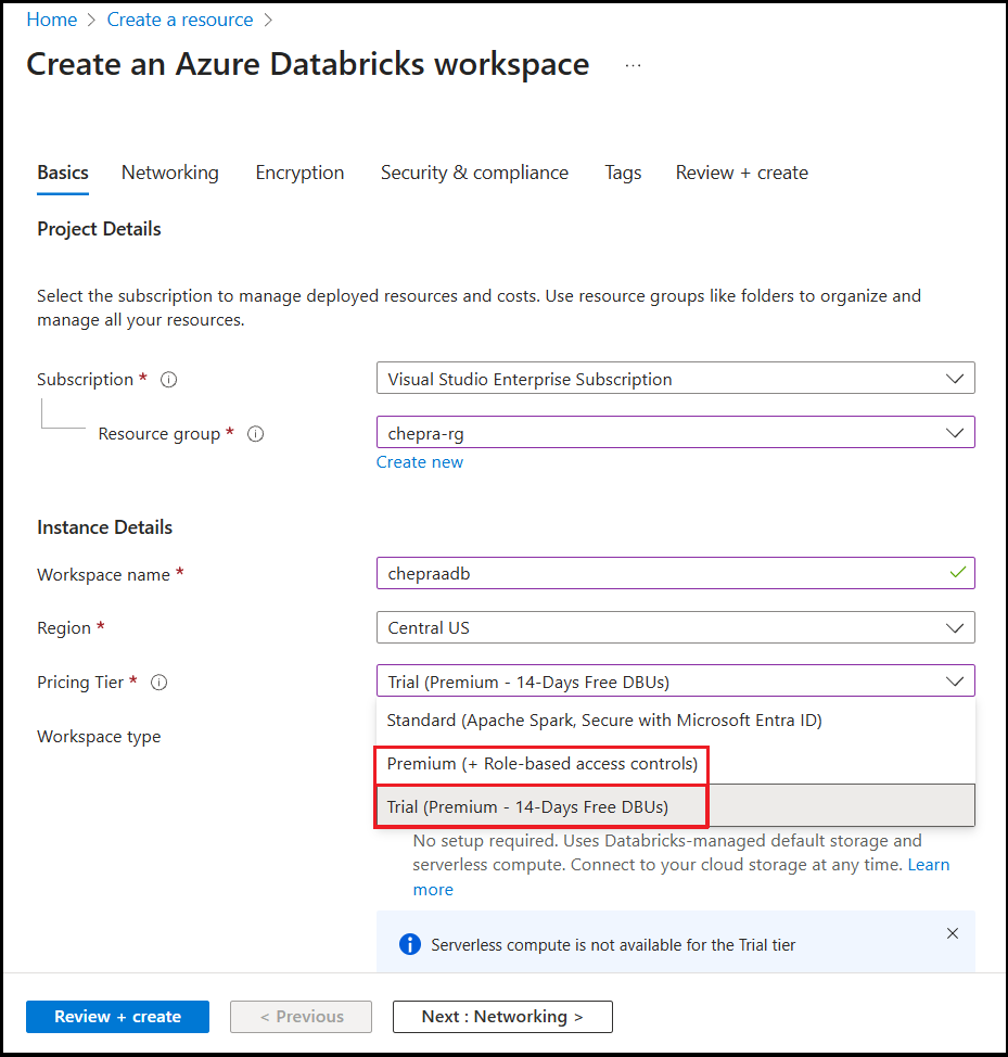

    Here’s a clear, step-by-step guide based on the official Microsoft Learn documentation for getting started with Unity Catalog on Azure Databricks, even if you’re using an Azure free trial:
    Prerequisites
    Azure Subscription
    • You can use an Azure Free Trial (includes $200 credit for 30 days).
    • Sign up at Azure Free Trial.
    Azure Databricks Workspace
    • Create a workspace in your subscription.
    • Choose Premium or Trial tier
    Azure Active Directory (AAD)
    • Unity Catalog uses AAD for identity and access management.
      • Ensure you have Global Admin or User Admin permissions to configure service principals.
    Azure Storage Account
    • Required for managed storage for Unity Catalog.
    • Create a Data Lake Storage Gen2 account and enable Hierarchical Namespace.
