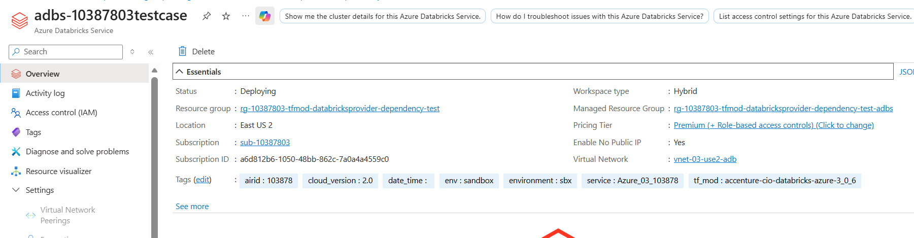

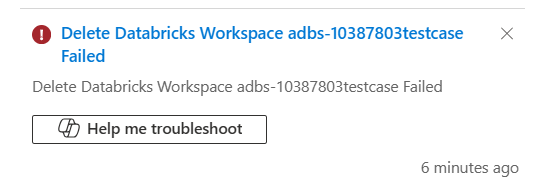

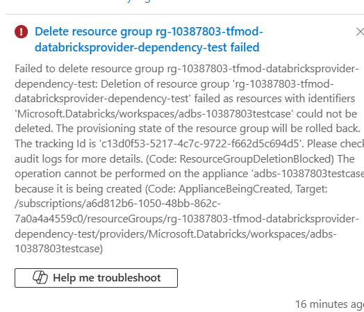

Currently databricks workspace is in deploying state and not able to delete or create

    The Databricks workspace is stuck in Deploying because the Azure Resource Manager (ARM) deployment failed or didn’t complete, leaving the resource in a locked transitional state. Common causes include failed dependencies (Managed Identity, Key Vault, networking) or partial provisioning.

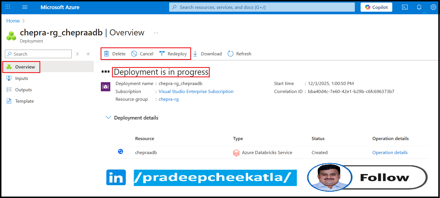

    If the Databricks workspace stays in Deploying for more than 30 minutes, it usually indicates a failed or stuck ARM deployment. Here’s what you should do:
    Actions Required to resolve this issue:
    Step1: Check Deployment Logs
    • Go to Resource Group → Deployments.
    • Look for the failed deployment and review error details.
    Step2: Cancel or Delete or Redeploy the Deployment
    • If the deployment is still active, Cancel it.
    • Then Delete the failed deployment entry.
    • Click on Redeploy

    Step4: Review the activity logs and remove manually.
    • Check Activity Logs for stuck dependencies (Managed Identity, Access Connector).
    • Remove them manually.
    • Retry deletion.

    It sounds like you're having an issue with your Azure Databricks workspace being stuck in a deploying state, which is preventing both deletion and creation of new resources. Here’s what you can do:
    1. Check Provisioning State: First, you can check the provisioning status of your workspace. You can do this by navigating to the Azure portal and checking the Activity log for your Databricks workspace. If the status is Failed, you may need to delete the workspace.
    2. Delete the Workspace:
      • Make sure that all clusters are terminated and that the workspace is no longer in use.
      • You can delete the workspace via the Azure portal or using the Azure CLI. If you’re using the CLI, run:
             az databricks workspace delete --resource-group <YourResourceGroup> --name <YourWorkspaceName> -y
      • If the workspace is in a Failed state, you might still be able to delete it. Make sure to confirm that it’s not locked or has any dependencies.
    3. Check for Locks or Dependencies: If
    you encounter issues while attempting to delete the workspace, check if there are any locks on it by going to the Locks section in the Azure portal, and remove any that might be preventing deletion. Also, make sure there are no dependencies that need addressing.
    1. Wait for Cleanup:
    Sometimes, the cleanup of resources after a deletion can take some time (5-10 minutes), so if you've initiated the deletion and it seems to be stuck, just give it a little while.
