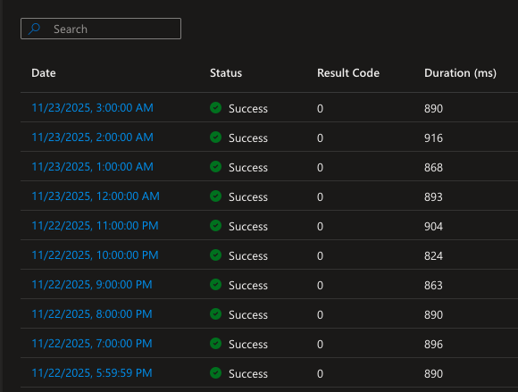

Having a weird problem as of late where my timer functions on one of my function apps stopped running on 11/23/2025 - this is weird because all of my other timer functions on my other function apps are still working as they should.
The function app in questionUser's image
The function used to run every hour without incident for months, but all of a sudden it stopped working - the function hasn't been touched nor edited since setting it up
Cron expression
Same situation with another timer function I have on this function app - stopped running on 11/23/2025, any help would be greatly appreciated as I have no idea what's happening
