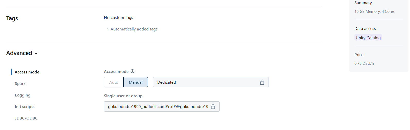

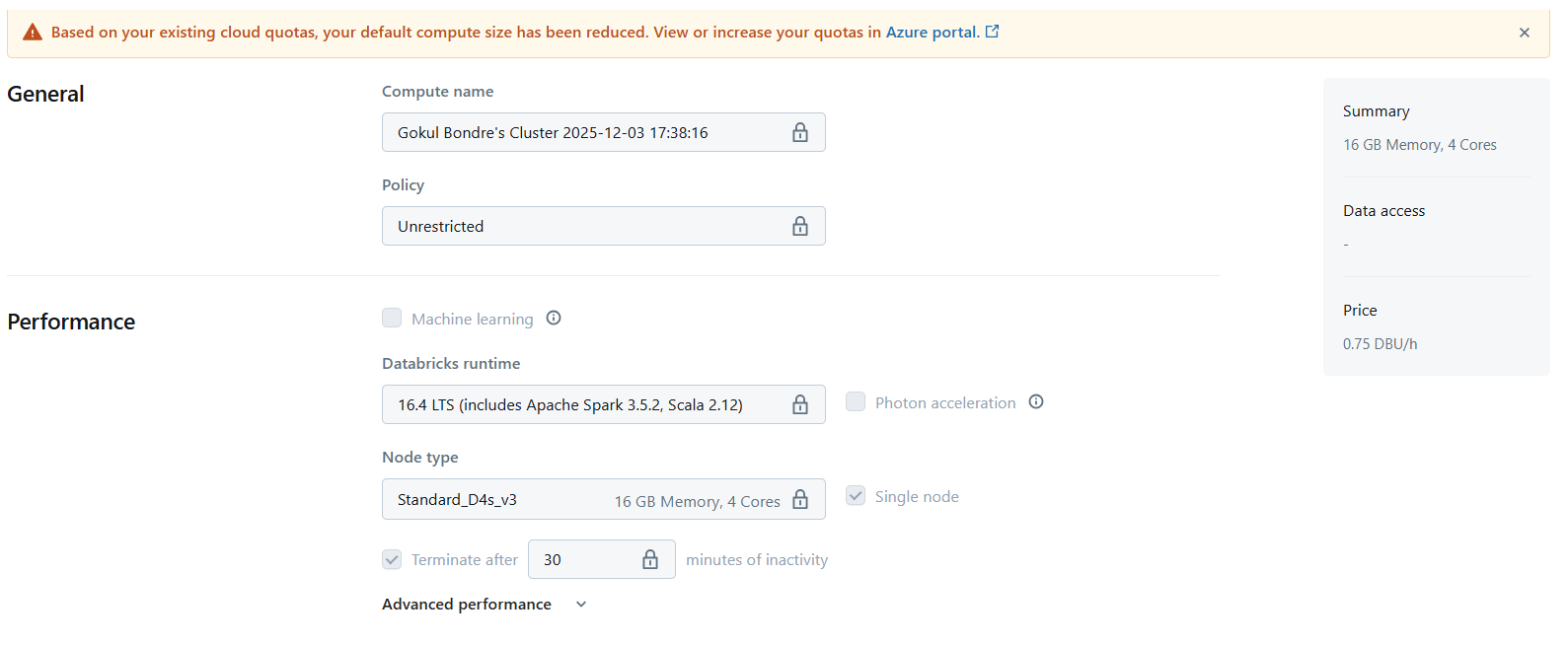

Below is cluster configuration
I have selected Manual and dedicated Access mode single user and Unity Cat logUser's image

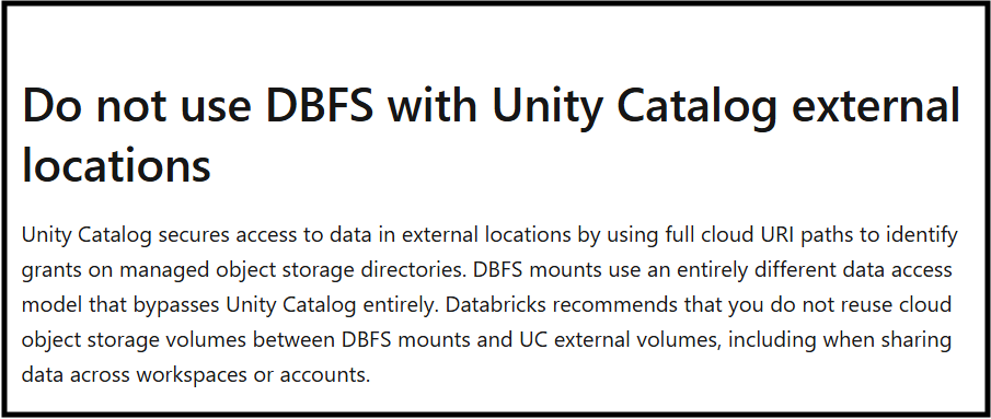

    Unity Catalog (UC) enforces strict access control policies, and traditional mounting techniquesโ€”such as using access keys or the dbutils.fs.mount commandโ€”are not recommended. Best practices for DBFS and Unity Catalog. User's image
    Databricks advises against using DBFS mounts for external data sources when working with Unity Catalog. Instead, it's recommended to use Unity Catalog's external locations/Volumes and storage credentials to manage data access, providing a more secure and governed approach.
