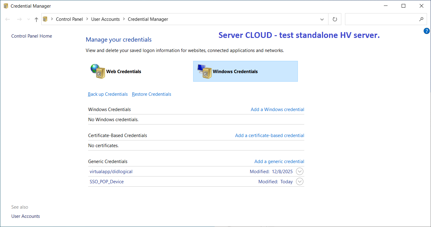

On Srv there're no current network sessions:01
On Test there are no cached credentials for Srv or kerberos tickets:
02
Theoretically in this case when accessing a network share on Srv from Test I'm expecting to see the authentication dialog requesting domain credentials but access is being granted as if the credentials had been already cached:
06
05

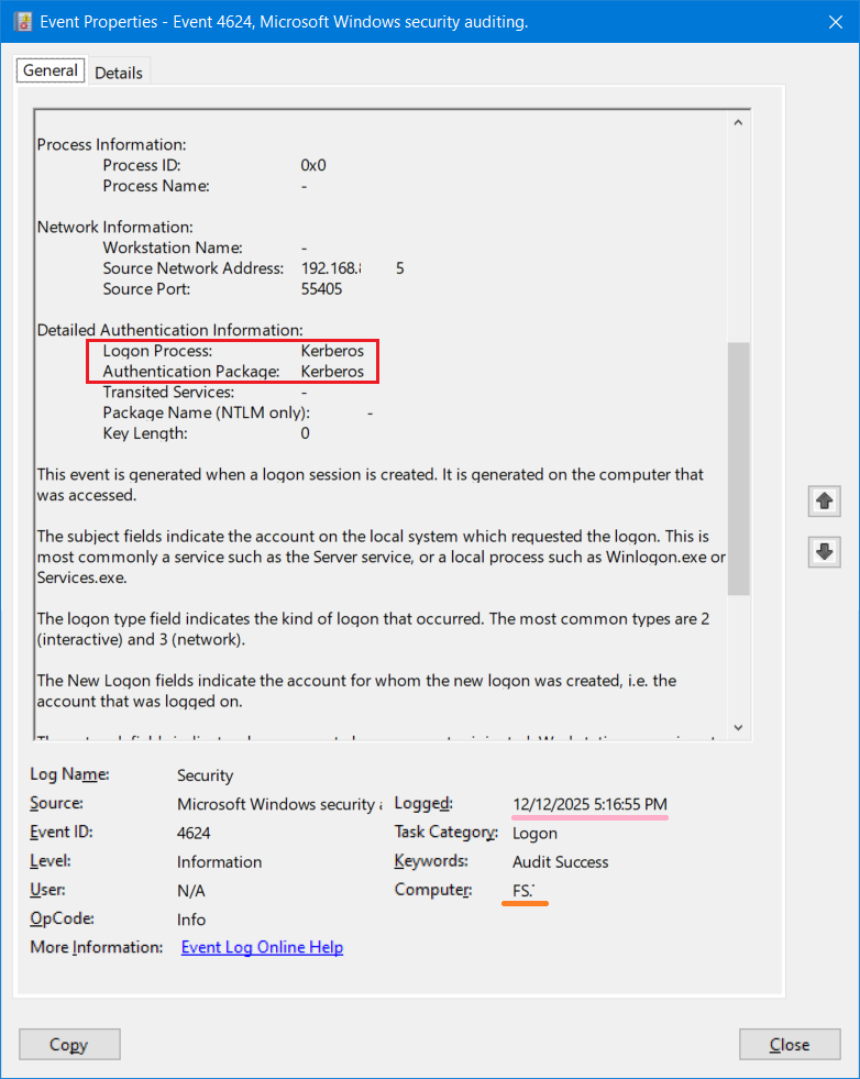

The event 4624 on Srv displays successful logon using KERBEROS authentication.
Would anybody please tell me where these cached credentials are kept if I can see them neither in Credential Manager nor in Klist? As far as I understand they should NOT stay in memory after the session is closed...

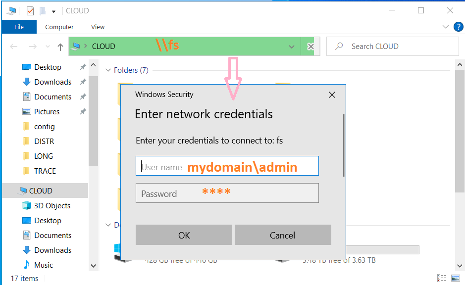

    Here's the test in which I 'm connecting from my testing stanalone server named CLOUD to my productional file server FS (domain-joined} and I'm doing it for the very first time - I've NEVER access FS from CLOUD before!

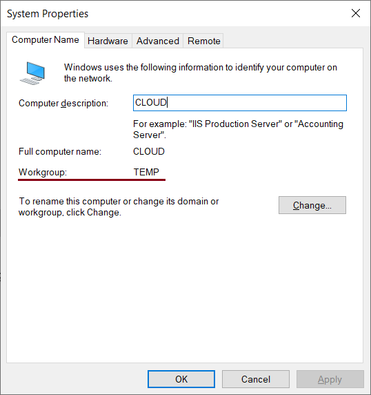

    1. The CLOUD standalone server
    00
    02

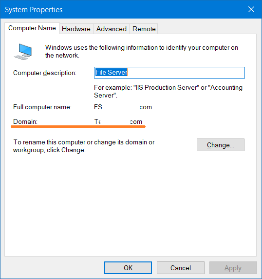

    2 FS - domain file server
    01

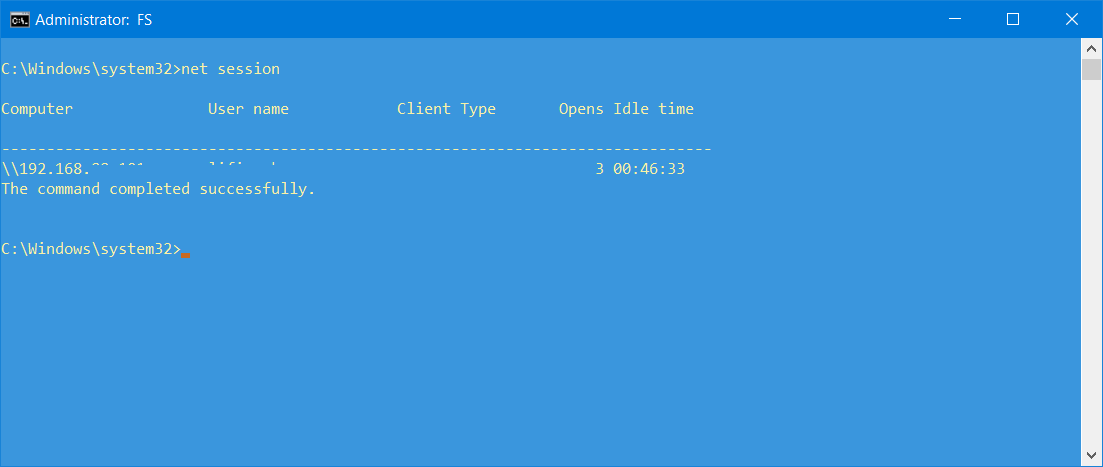

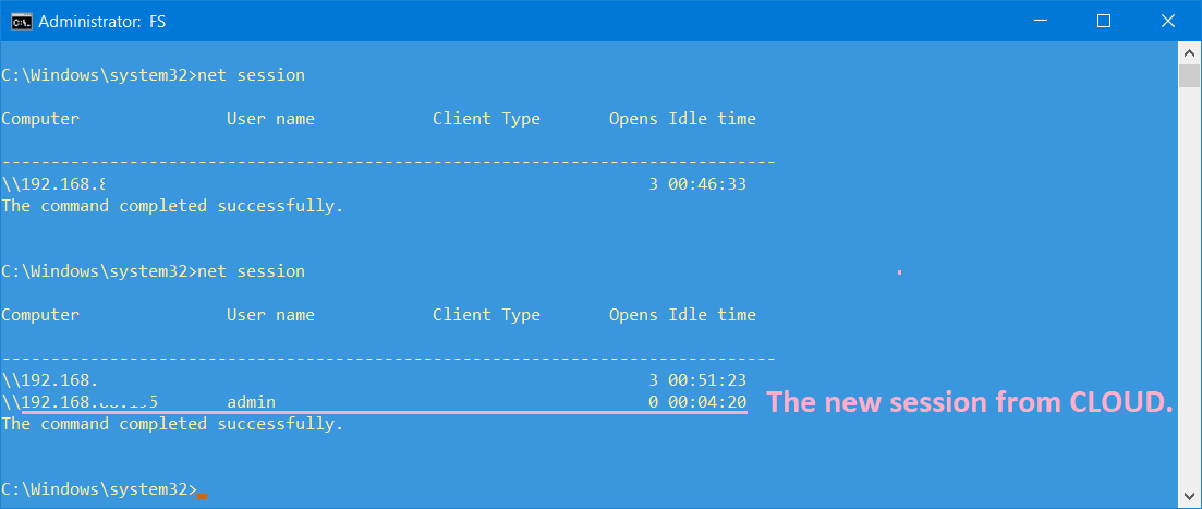

    3 Currently there's only one session on FS - and this session is NOT from CLOUD:
    04

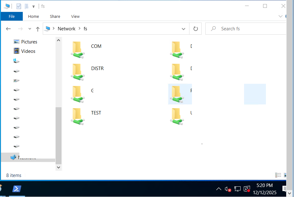

    4 I access \FS from CLOUD:03
    05
    06

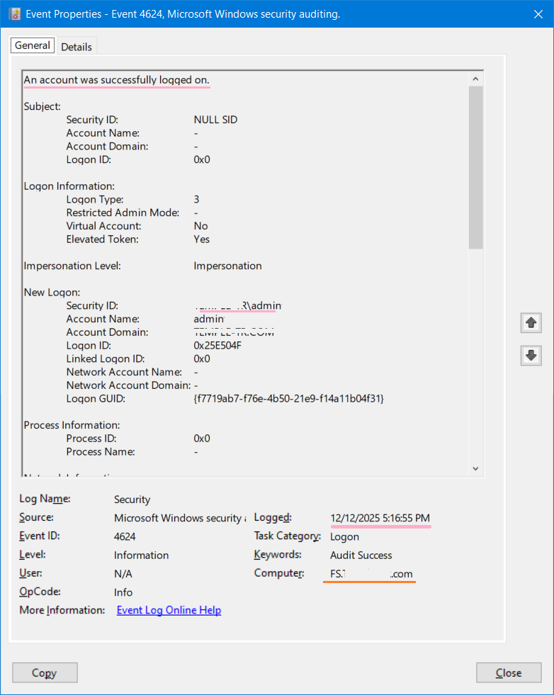

    1. The resulting event 4624 on FS's Security log:07
    08
