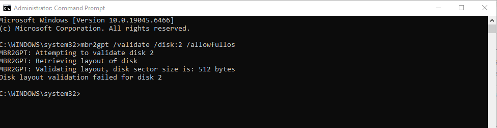

So trying to convert my MBR disk to GPT so i can disable CSM support and run in secure boot
then I should be able to upgrade to windows 11?

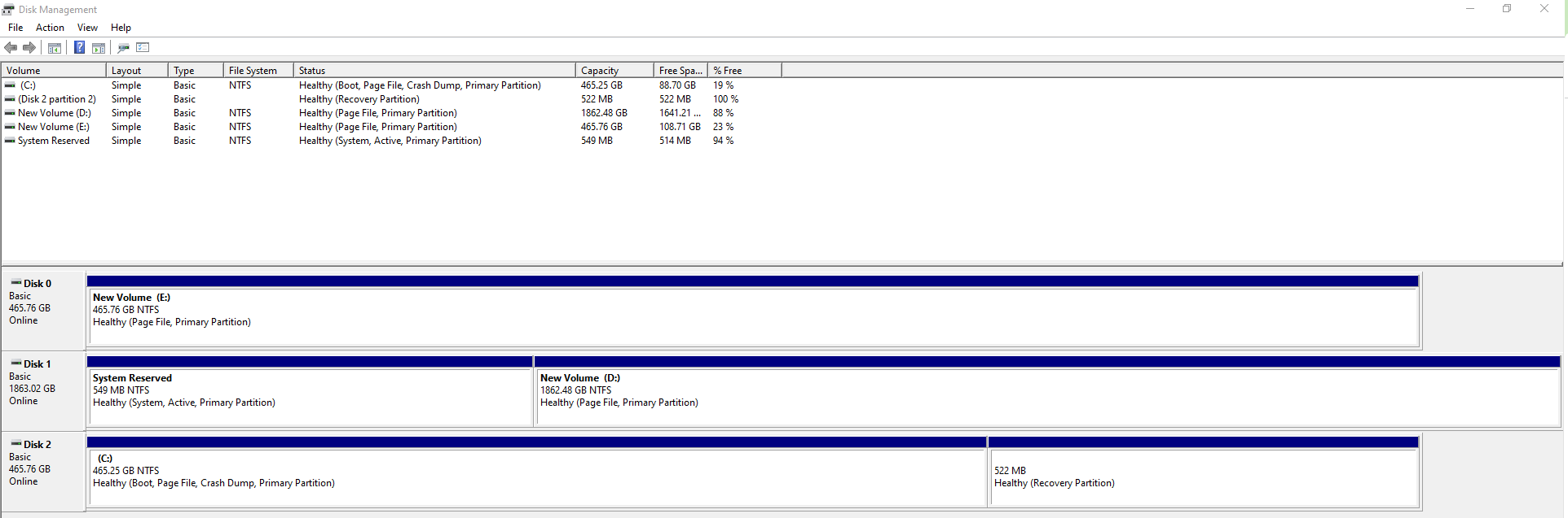

When validating my Disk 2 C (where windows is) it has failed

    3. Run MBR2GPT with Correct Parameters: Use the command MBR2GPT /validate /disk:<diskNumber> to check if the disk is eligible for conversion. Make sure to replace <diskNumber> with the correct number of the disk you are trying to convert.
    4. Check for Errors: If the validation fails, check the logs generated by MBR2GPT for specific error messages that can provide more insight into what went wrong. You can specify a log directory using the /logs:<logDirectory> option.

    From your screenshots, the problem with mbr2gpt failing to validate the disk seems to be caused by the boot partition being on Disk 1 and Windows 10 is installed on Disk 2, was Windows previously installed on Disk 1.
    There are some 3rd party utilities available that claim to be able to convert the drive from mbr to gpt without data loss, try one of those, but it is best to backup all your files before trying to convert the drive to ensure against data loss.
  3. Volume Z 1,140 Reputation points Volunteer Moderator
    2025-12-09T07:29:34.34+00:00
    Try the following; Run
    bcdboot C:\Windows /s C:
    Mark drive C as active in Disk Management. Shut down, remove disk 1 and start up.
