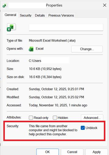

    1- Remove the Mark of the Web (MOTW)
    • Open File Explorer, navigate to your Excel file that you need to enable macros
    • Right click on it and choose Properties
    • In General tab, check the Unblock box for the Security option.
    • If the Unblock options is not available, it's usually because that your file is currently saved in a OneDrive or SharePoint folder and it will be considered as from the internet.
    • You can try disconnecting OneDrive/SharePoint temporarily or move the file to your local folder and try the Unblock Security box again.

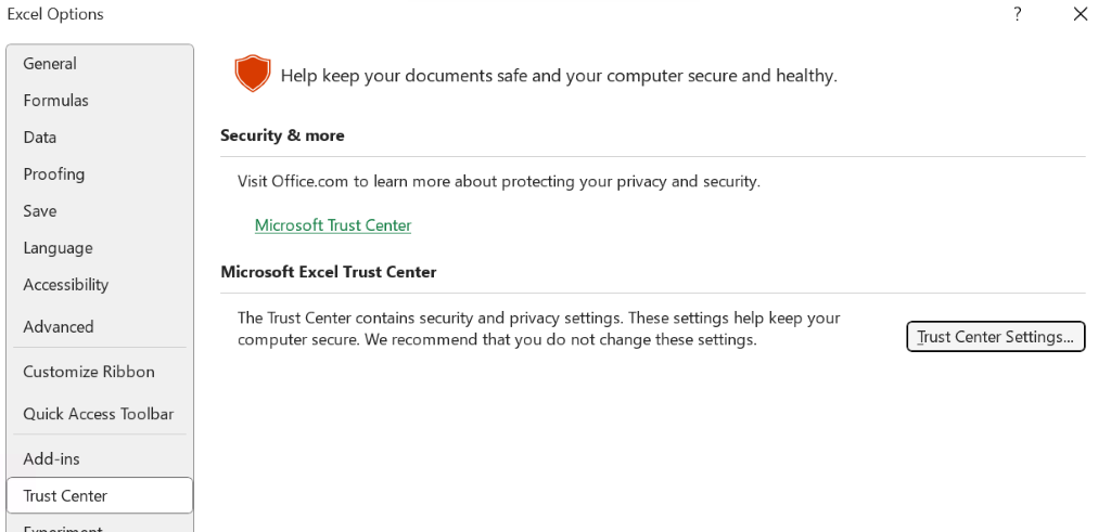

    2- Add the file location as a trusted location
    • Open Excel and go to File > Options > Trust Center > Trust Center Settings
    • Select Trusted Locations in the left bane > Add new location > Browse and navigate to the folder where you keep the files need to enable macro
    • Press OK to close all the dialog boxes then try opening your macro-enabled excel file again
    3- Enable macros in Excel
    • Open the Excel file that needs macro enabling.
    • If you see a yellow warning bar at the top with the message "SECURITY WARNING: Macros have been disabled", click Enable Content to enable macro for the file
    You can also adjust the trust center settings for macros by
    • Go to File > Options > Trust Center > Trust Center Settings
    • Click Macro Settings and choose between "Disable VBA macros with notification" (which will show a yellow warning bar as I mentioned above) and "Enable VBA macros" (only if you're sure the file is safe)
    • Then click OK to save the settings
