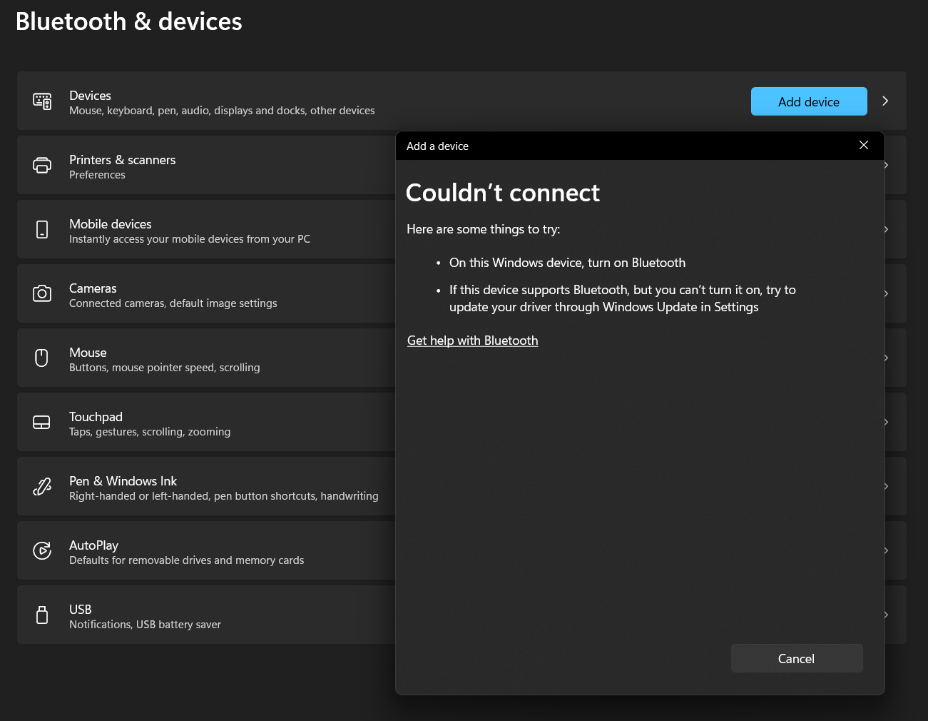

I encountered endless BSODs yesterday, and the Bluetooth button is gone? I can't even turn it on directly in settings because whenever I try to add a device, it immediately says "Couldn't Connect." I tried following the troubleshoot steps and restarted it; still nothing. Screenshot 2025-12-12 102322

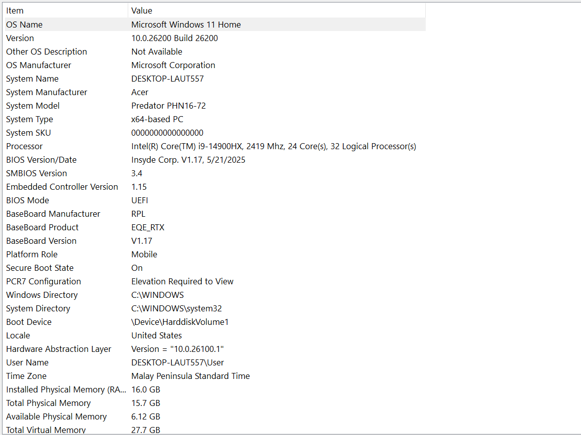

    If it is a laptop or desktop, if possible, could you provide the laptop model or your desktop configuration?
    Access the c:\windows\minidump folder, copy the files to your desktop, then upload them to OneDrive or Google Drive and post the link here for analysis.

    It's possible it's a hardware problem, but let's try checking all drivers and updating the BIOS.
