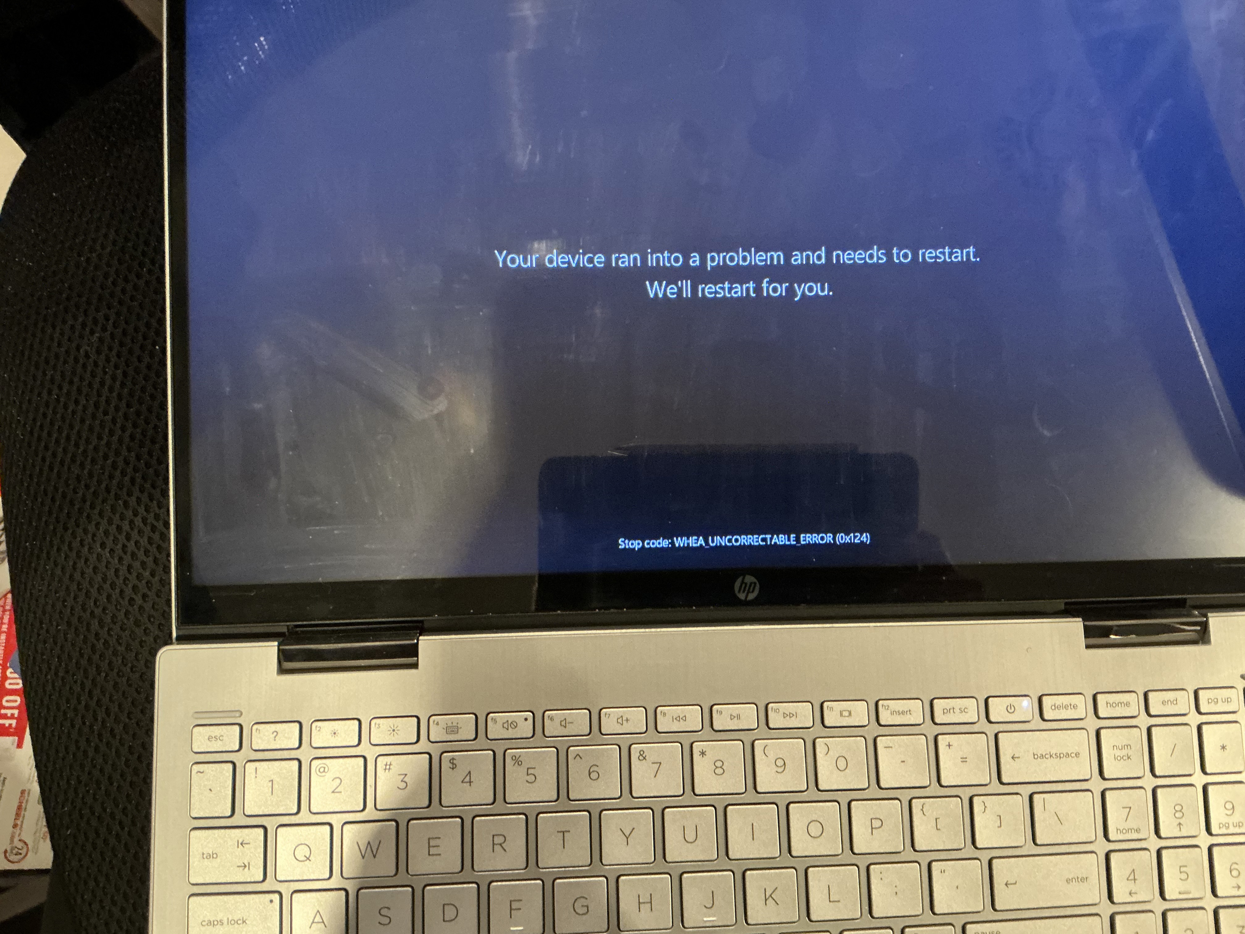

When I turn my laptop on it starts to load in, sometimes it loads into windows, then it freezes and says it ran into a problem and restarts. After it restarts it crashes and prepares automatic repair, opens up BitLocker but not enough time to enter the recovery key, goes to your device ran it a problems and needs to restart. We’ll restart for you. And has stop code: WHEA_UNCORRECTABLE_ERROR (0x124). Then it loops this cycle until it freezes. And will not unfreeze until turned off or it dies.

  2. Igor Leyko 108K Reputation points Independent Advisor
    2025-12-13T23:27:37.79+00:00
    in general, this stop code means hardware problem but in some cases, it may be caused by drivers.
    Can you share several minidumps to OneDrive for analysis?
    Please check if the problem exists in the safe mode.
    https://support.microsoft.com/windows/start-your-pc-in-safe-mode-in-windows-10-92c27cff-db89-8644-1ce4-b3e5e56fe234
    Tell the result.
  3. Igor Leyko 108K Reputation points Independent Advisor
    2025-12-14T00:19:33.59+00:00
    Did you try to select same mode using installation media?
    You may boot from installation media and use command prompt to copy minidumps to this media, then use another PC to upload dumps to OneDrive.
  4. Igor Leyko 108K Reputation points Independent Advisor
    2025-12-14T16:37:09.9233333+00:00
    Please boot your PC from installation media not from hard drive.
