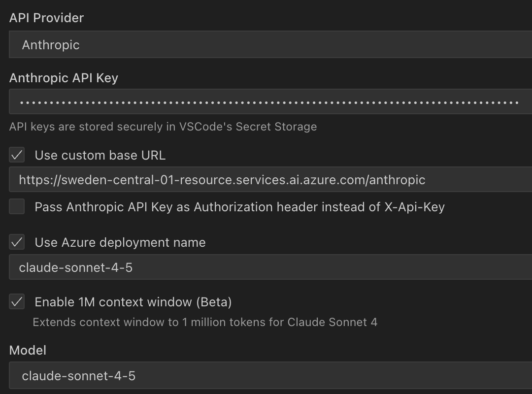

GD-2997 75 Reputation points
2025-12-16T21:53:08.95+00:00
While technically the correct answer to the question - the OP will want to use the Anthropic API provider in external tools. This is likely because the OpenAI standard API will not support things like Anthropic's caching. But the Azure Foundry API endpoints appear fully compliant with Anthropic's API and do not do anything crazy Foundry specific.
Another gotcha: the base URL is expected with the /anthropic route at the end.
See the screenshot below for a working config example:
Screenshot 2025-12-16 at 22.43.53
